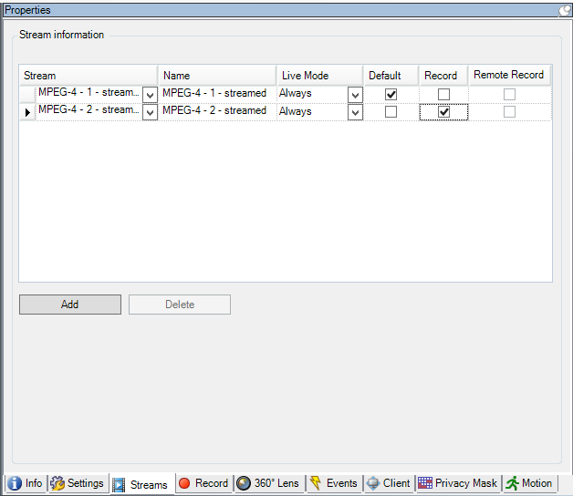

Streams tab (devices)
The following devices have a Streams tab:
  • Cameras
The Streams tab lists by default a single stream. It is the selected camera's default stream, used for live and recorded video.
Streams tab overview for a selected device.
Tasks on the Streams tab
Name
Description
Record Select this check box to change which stream to use for recording. For live streaming, you can set up and use as many live streams as the camera supports, but you can only select one stream for recording at a time.
Add
Click to add a stream to the list.
Add a stream
