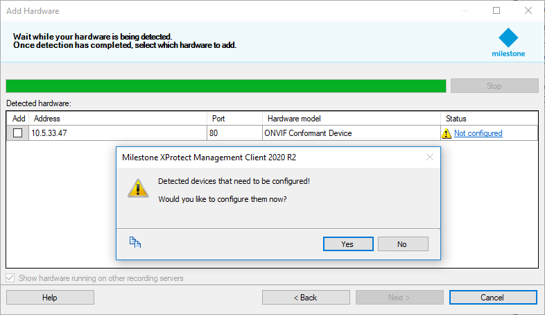

While a device is being added to a Recording Server, the driver will attempt to determine whether the device is in Factory Default State. If so, the VMS will prevent the user from adding the device, and will prompt them to perform an initial configuration procedure on the device:
Graphical user interface, text, application
Description automatically generated

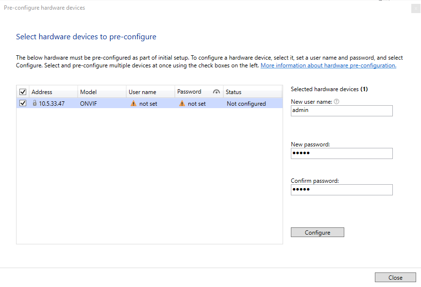

The user will have the opportunity to configure the device with administrator credentials in order to transition to Operational State:
Graphical user interface, text, application, email
Upon clicking “Configure”, the device will be configured into Operational State:
Once the device is in Operational State, and the pre-configuration dialog is closed, it can be added to the Recording Server as usual:
