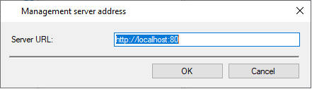

Change management server address
To change the management server address, follow these steps:
  1. On the computer where the XProtect DLNA Server service is installed, right-click the XProtect DLNA Server Manager tray icon and select Management server address.
    Management server address dialog box.
  2. Specify the new information and click OK.
  3. You must use the domain name or the IP address of the server where the management server is installed.
    The XProtect DLNA Server service restarts and the tray icon turns green.
