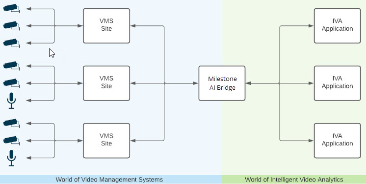

VMS applications and IVA applications are, by nature, very different. The code bases used to develop the applications and the operative systems they run on are entirely different. While VMS applications predominately use Microsoft Windows technology, most if not all IVA applications are developed for the Linux operating system and often consist of several docker containers.
The purpose of Milestone AI Bridge is to make it easy for developers of IVA applications to integrate their solution with the XProtect VMS.
VMS applications and IVA applications cannot communicate directly with each other, but they can through Milestone AI Bridge.
Illustration showing how the XProtect VMS and IVA applications communicate through Milestone AI Bridge.

Most communication and exchange of data between the XProtect VMS and the IVA applications happens through Milestone AI Bridge by using various standard protocols. The only exception is the web page on which you draw the graphical representation of the selected analytics topic. This web page is sent directly from the IVA application to XProtect Management Client.
