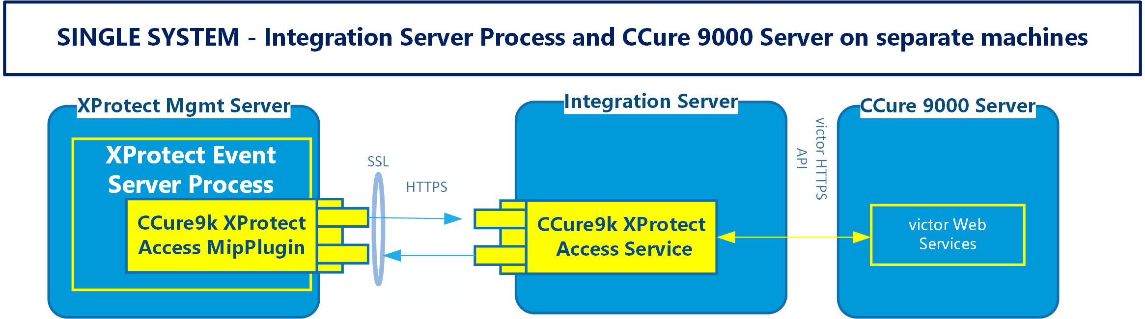

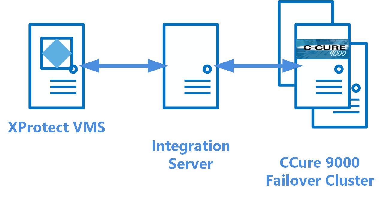

CCure 9000: Alternate configuration
In some systems the CCure 9000 server cannot host additional software components. If the CCure 9000 software is being supported by a failover cluster, then the MilestoneCCure XProtect Access Service will need to be installed on a different server in the same network, a server that we will refer to as an integration server
In this scenario it is possible to configure the integrated system with a separate server as the host for the XProtect Access service.
Failover clustering is not the only scenario that may require installing the integration components on a separate host machine. No matter the reason - redundancy, isolation of services, separation of maintenance responsibility, etc., this alternate configuration option is fully supported.
