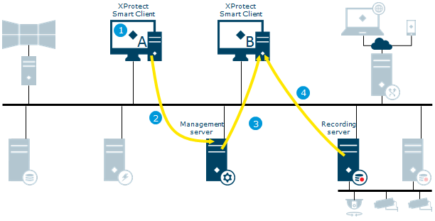

Matrix
  1. XProtect Smart Client user selects to send a camera to a Matrix-recipient
  2. Information is sent to management server
  3. Management server sends request to Matrix-recipient on specified IP address and port (XProtect Smart Client B)
  4. Streams are sent to XProtect Smart Client from recording server on request

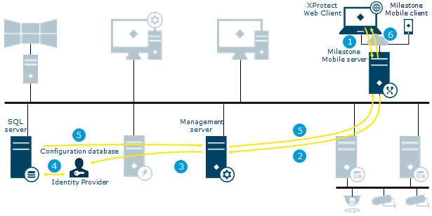

Login from XProtect Web Client and XProtect Mobile as an AD user
  1. Login request from XProtect Web Client or XProtect Mobile received on the mobile server
  2. The mobile server forwards request to the management server
  3. The management server contacts Active Directory to authenticate the user
  4. User-specific configuration is retrieved from the SQL database
  5. Information returned to the mobile server
  6. The login is granted and configuration is sent to XProtect Web Client or XProtect Mobile

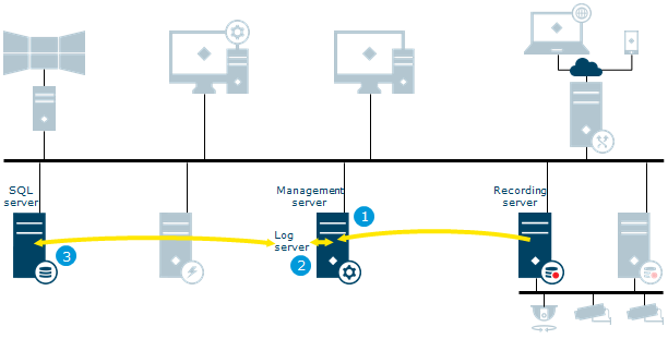

Log server
  1. The Management server or recording server creates a log message
  2. The log message is forwarded to the log server
  3. The log message is stored in the log server's SQL database

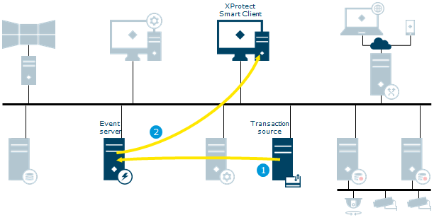

XProtect Transact
  1. Transaction data generated by the transaction source is sent to the event server and stored
  2. The event server sends transaction data to XProtect Smart Client. View items containing transaction data and the associated video is updated

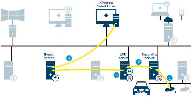

XProtect LPR
  1. Live streams from cameras configured for LPR (License Plate Recognition) retrieved by the recording server
  2. Streams from the recording server retrieved by the LPR server
  3. The LPR server recognizes license plates by comparing them with the license plate styles of the installed country modules. Found license plates are compared with the match list requests from the event server LPR plug-in
  4. The event server sends events and alarms to XProtect Smart Client when there is a match
