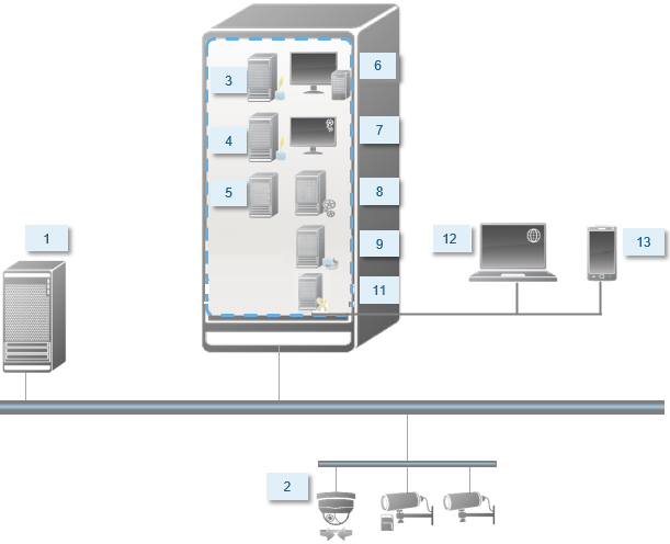

Single Computer installation
Typical system components in a system:
- Active Directory
- Devices
- Server with SQL Server
- Event server
- Log server
- XProtect Smart Client
- Management Client
- Management server
- Recording server
- Failover recording server
- XProtect Mobile server
- XProtect Web Client
- XProtect Mobile client
- XProtect Smart Client with XProtect Smart Wall
