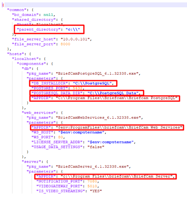

- If you want to change the target directory for a server application or its associated data from C:/ to a different location, open the config.json file (located in the deploy folder) and change all of the paths that are highlighted in the illustration below to the new location. Note that If you change the target drive, you should make sure that it is an SSD drive

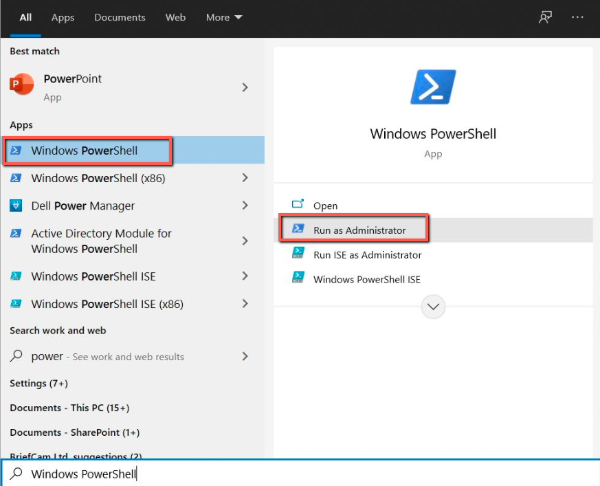

Open Windows PowerShell 64 bit as an Administrator.

If a domain user is required, set the domain name itself in the config file (config.json):
"bc_domain: "user-domain-name"

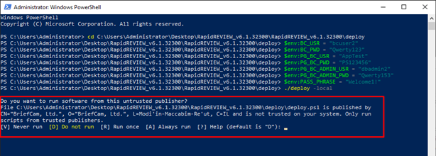

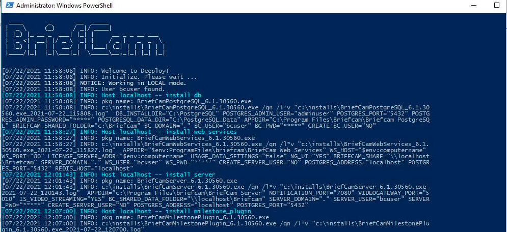

Run the following command to start the installation:
.\deploy.ps1 -local
For example:
If a message appears about an untrusted publisher, type in R.
The installation may take 10-25 minutes.

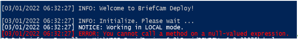

Cannot call method on null-valued expression error
If you receive the You cannot call a method on a null-valued expression error, this means that you did not properly set the environment variables as described in step 7 above. Try resetting the variables and then rerun the installation by following step 3 below.
General Installation Troubleshooting
If the installation failed:
- Investigate the log files (deploy.log and deploy-trace.log) and fix the issue.
- Reinstall BriefCam:
- Run the following command in PowerShell to remove all installation components:
- Rerun the installation script.
.\deploy.ps1 -uninstall -local -purge

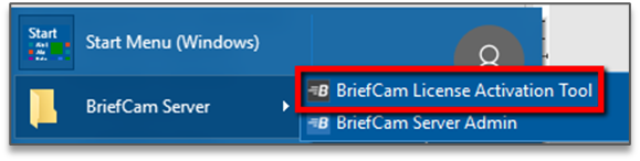

STEP 3 – Activate the BriefCam license

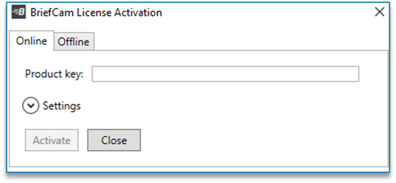

On the XProtect Rapid REVIEW computer, launch the BriefCam License Activation application from the Start menu.
Enter the product key that you received from BriefCam, and click Activate.

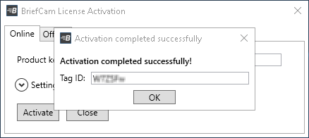

Upon successful activation, the following dialog box will appear.
Click OK to close the dialog box, and then click Close in the main application window to close the License Activation application.

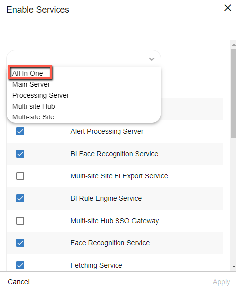

From the Templates menu, select All In One, and click Apply.
Clear the Alert Processing Server, BI Face Recognition Service, and BI Rule Engine Service check boxes (these options will not be needed).

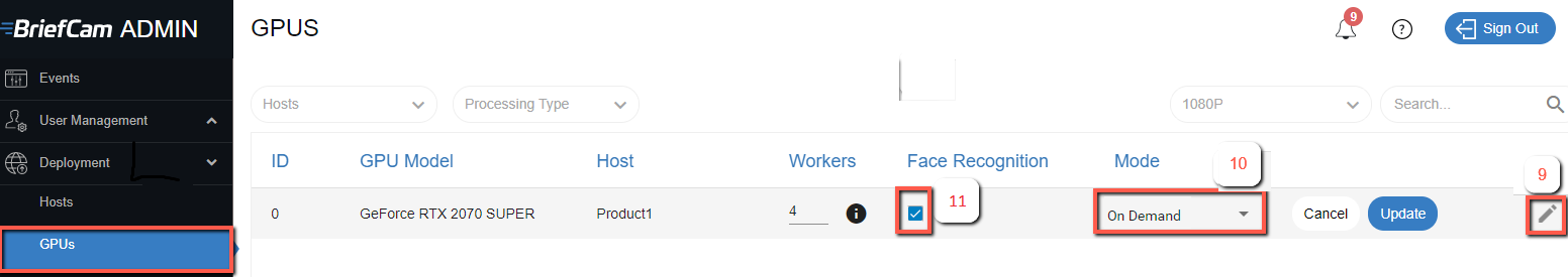

From the Deployment section, click GPUs.
Click on the edit icon (
In the Mode column, select On Demand.
If face recognition will be used, select the Face Recognition check box.
Verify that the number of workers under Workers is set to 4.

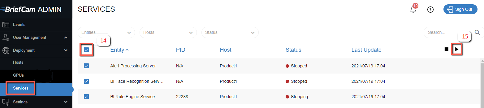

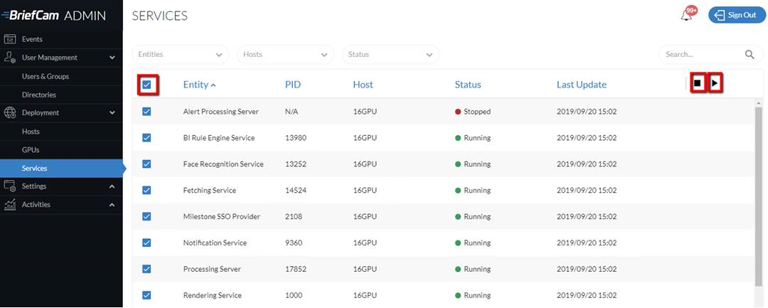

From the Deployment section, click Services.
Select the check box at the top left of the table.
Click the start button (as shown in the image below).

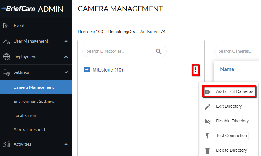

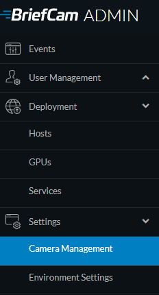

Open the Settings section and click Camera Management (as shown in the image below).

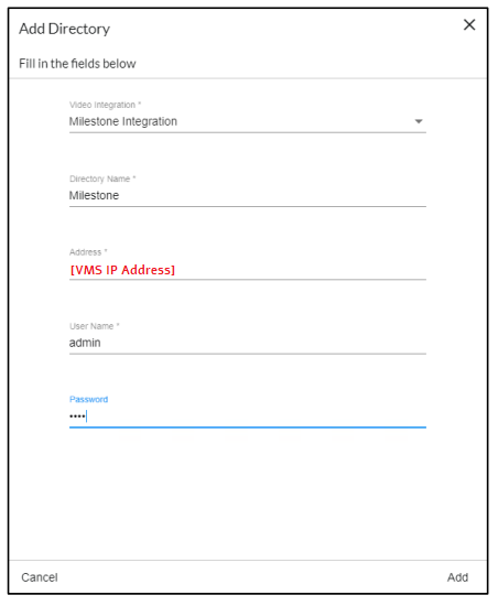

Click Add directory. The Add Directory dialog box opens.
From the Video Integration field, select Milestone Integration.
In the Directory Name field, enter a display name for the user directory.
In the Address field, enter the address of the Milestone VMS server.
In the User Name and Password fields, enter an administrator user name and password of the VMS server. With an admin user you can make sure that all the cameras can be accessed.
Click Add to add the directory.
Click the zoom (
) icon to the right of the new directory and select the Add / Edit Cameras option.

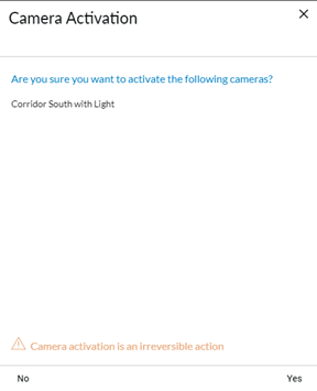

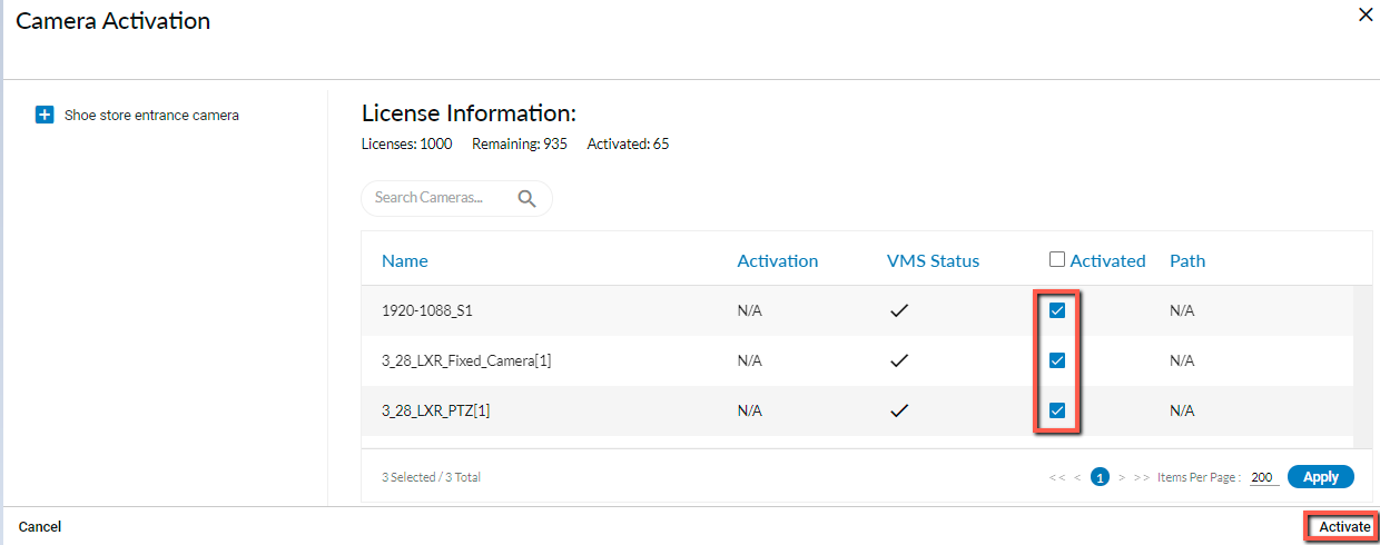

For all of the cameras, select the check box in the camera’s Activated column and click the Activate button (located in the bottom right corner), as shown in the image below.
The Camera Activation pane shown below will appear. If you are sure you want to activate the cameras, click Yes. Note that Camera activation is irreversible. It cannot be reset unless a special approved request is opened with BriefCam support.

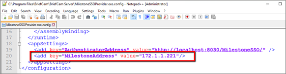

STEP 7 – Update the SSO address
On the XProtect Rapid REVIEW computer, go to C:\Program Files\BriefCam\BriefCam Server and open the MilestoneSSOProvider.exe.config file.
Edit the MilestoneAddress setting with the IP address of the Milestone VMS server in the value portion of the line.
Note: If STEP 7 is performed later, you will need to restart the IIS services.

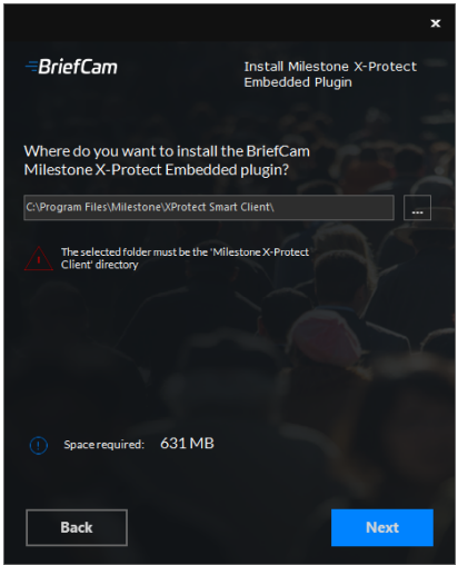

Select the installation destination path and click Next.
Note that the installation path must be the same directory where Milestone XProtect Smart Client is installed. (This may vary slightly between client computers and between Milestone versions.)

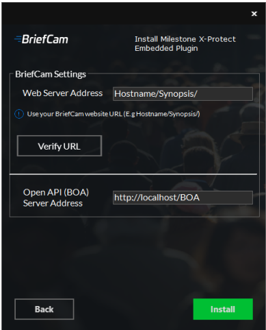

Enter the BriefCam Web Application URL (which is the hostname or IP address of the BriefCam computer followed by /synopsis and verify that the provided URL is correct by clicking the Verify URL button (as shown below).
In the BriefCam Open API (BOA) Server Address field, enter the hostname or IP address of the BriefCam computer followed by /BOA.
Click Next.
Click Install and then click Finish.

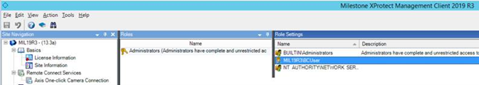

Note: An admin user is automatically created by the SSO when logging into the Milestone client using the Basic authentication or Windows authentication method.
If you want to log into the Milestone client using the Windows authentication (current user) option, add the BriefCam user (by default this is BCUser) to the Administrators group in MilestoneXProtect Management Client.

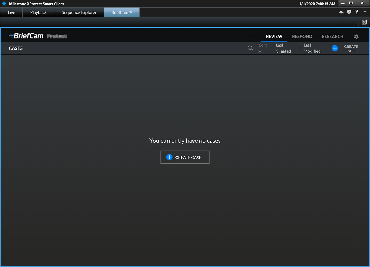

When you have completed the steps, a BriefCam tab will appear in the MilestoneXProtect Smart Client.

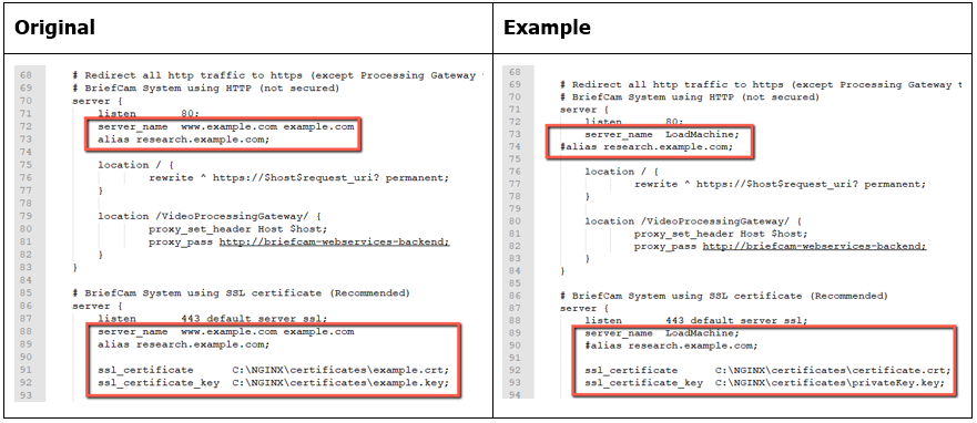

STEP 9 – Using an HTTPS host (optional)

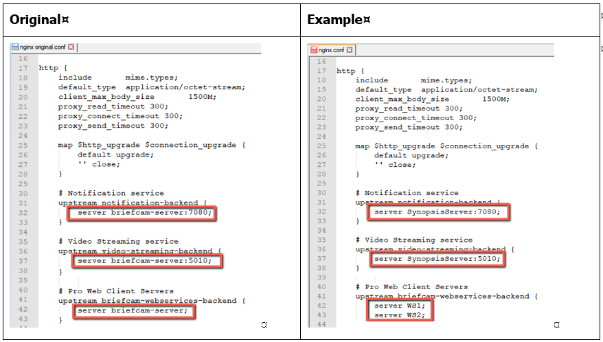

To work with SSL and BriefCam, using a load balancer is required.
This section describes the steps to take to use the NGINX load balancer as an https host for BriefCam services.
Recommendations
BriefCam recommends using NGINX.
It is recommended to install the load balancer on a separate computer.
If you are working in a virtualized environment, the load balancer must be on a separate computer.

Download the nginx.conf file from: https://bcftpuser:BCreleases01!@bcftp.briefcam.com/nginx/nginx.conf and save it to c:\nginx\conf (replacing the existing file).
In the nginx.conf file’s http section, modify the server name where the components are running (web services, notification services, and Video Streaming Gateway Services).
If you have multiple nodes of a service, add a semicolon (;) after the first node and add a second row with the name of the second node. In the example below, there are two Web Services nodes.
In the nginx.conf file’s BriefCam System using SSL certificate section you set up HTTPS as follows:
In the server_name node, replace www.example.com with the address of the load balancer.
Comment the alias node by adding an ampersand (#) at the beginning of the row.
In the ssl_certificate row, enter the full path to the .crt file including the file name.
In the ssl_certificate_key row, enter the full path to the .key file including the file name.
