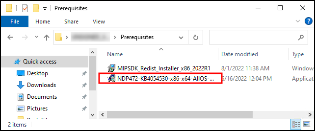

  • Make sure the .NET Framework 4.7.2 is installed if you are using version 2.70 or 2.80 of CCure 9000
When you integrate with the CCure 9000 2.70 or 2.80 versions, you must install Microsoft Windows .NET Framework 4.7.2. before you install the server and client integration components.
This prerequisite package is for all CCure 9000 client and server locations. You must install the .NET Framework 4.7.2 components and reboot each server or workstation prior to installation of the integration components. The runtime installation application is available in the Prerequisites folder of the installation package, available at:
  • https://download.milestonesys.com/ccure9k
2.90 and higher versions of CCure 9000 include the .NET components, so they don't need the same prerequisites as earlier versions.
