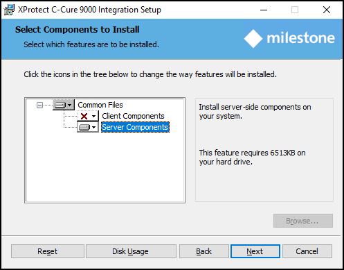

  1. Double-click the XProtectVideoPush-v3_XX-CCure9k-vX-XX.msi file to start the installation.
  2. Click Next to enter the component selection step. When you install on a CCure 9000 server that will not require the client components, open the Client Components list and select the Entire feature will be unavailable option.
  3. Open the Server Components list and select the Will be installed on local hard drive option.
  1. Click Next to continue. If you need to change the installation directory, at the next step, click Back and then select the “Browse…” button. The default installation location is: C:\Program Files (x86)\Tyco\
  2. Click Install to complete the installation process.
