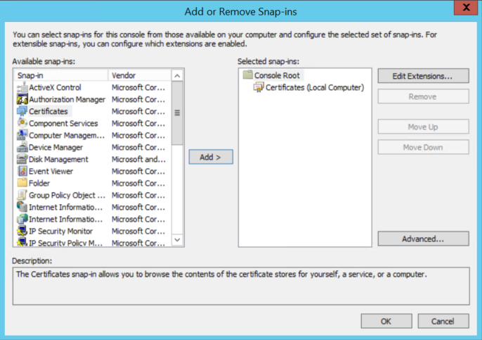

  1. On the computer that hosts the XProtect server, open the Microsoft Management Console.
  2. In the Microsoft Management Console, from the File menu select Add/Remove Snap-in….
  3. Select the Certificates snap-in and click Add.
    Click OK.

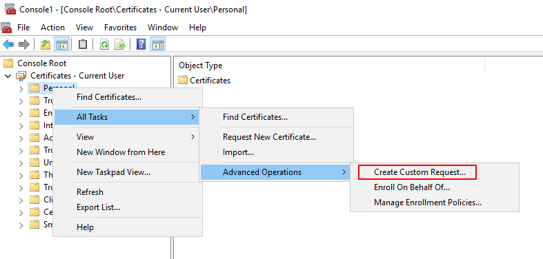

  4. Expand the Certificates object. Right-click on the Personal folder and select All Tasks > Advanced Operations > Create Custom Request.
    Right click Personal certificate store, choose All Tasks > Advanced Operations > Create Custom Request.

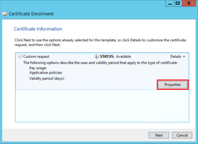

  7. Expand to view the Details of the custom request, and click Properties.

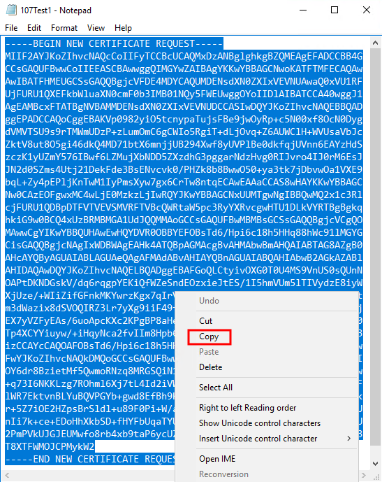

  1. Browse to the location of the .req file and open it in Notepad.
    Copy the entire file contents.
  2. Copy the entire contents of the file. This includes the dashed lines marking the beginning and the end of the Certificate Request.

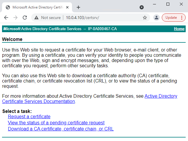

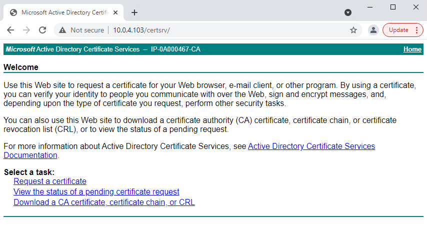

  3. Open a web browser and enter the address of the internal CA, which should be located at: [ ip.ad.dr.ess/certsrv ].
    Where, ip.ad.dr.ess is the IP address or DNS name of the internal network AD CS host server.
    Internal CA site to upload our copied text from the .REQ file.

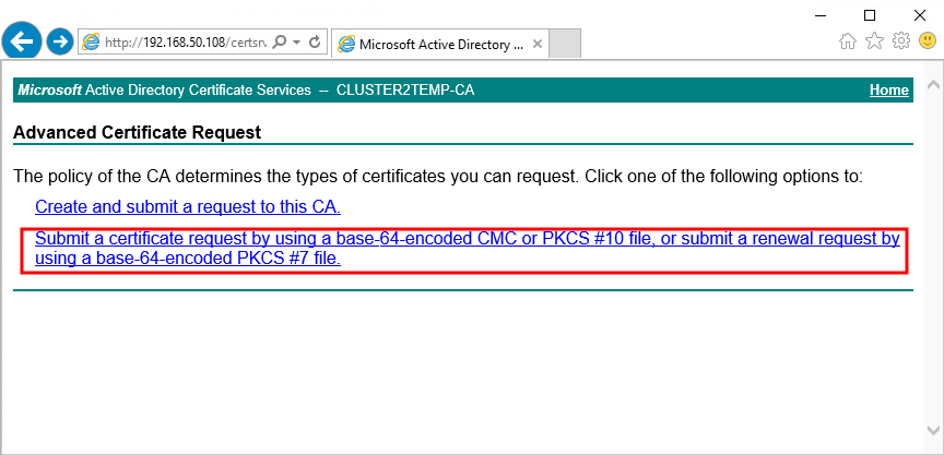

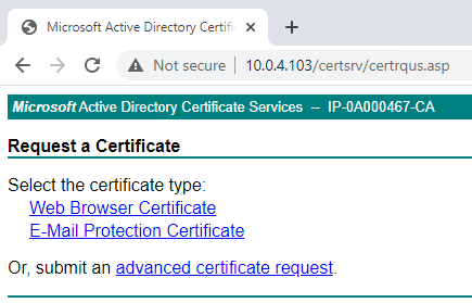

  4. Click the Request a certificate link.
  5. Click the advanced certificate request link.
    Advanced Certificate Request.

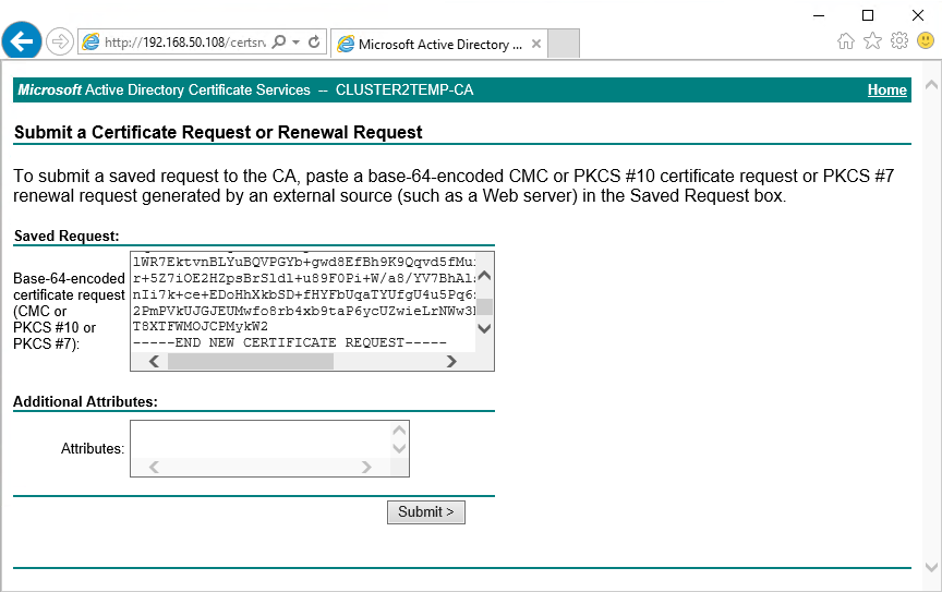

  6. Choose to Submit a certificate request by using a base-64-encoded CMC file.
    Base64 Cert Request
  7. Paste the contents of the .req file into the form. If it is required to select a Certificate Template, select Web Server from the Certificate Template list.
    Paste the entire .req file contents into the form.

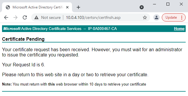

  8. Click Submit.
    The site shows a message that the certificate will be issued in a few days.
    • Internal CA servers can be used to manually issue certificates
    • Make a note of the date and time when the certificate request was submitted

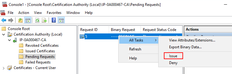

    In the Pending Requests folder, right-click on the matching Request ID, and from the All Tasks list, select Issue.
    Issue a cert manually from the MMC Certificate Authority snapin.

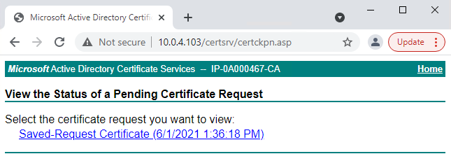

  4. Open a browser and go to the Internal CA IIS site located at [ ip.ad.dr.ess/certsrv ].
    Click the View the status of a pending certificate request link.
    Click the View the status of a pending certificate request link to download the issued certificate.
  5. If the certificate has been issued, a link will be available on the resulting page that contains the date of the certificate request.

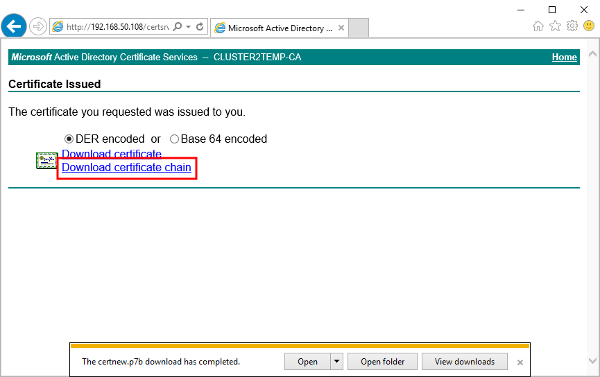

    Click the link with a date and time that matches the date and time that the certificate request was submitted.
  6. Select DER encoded, and download the certificate chain.
    Choose to download the DER encoded certificate chain.

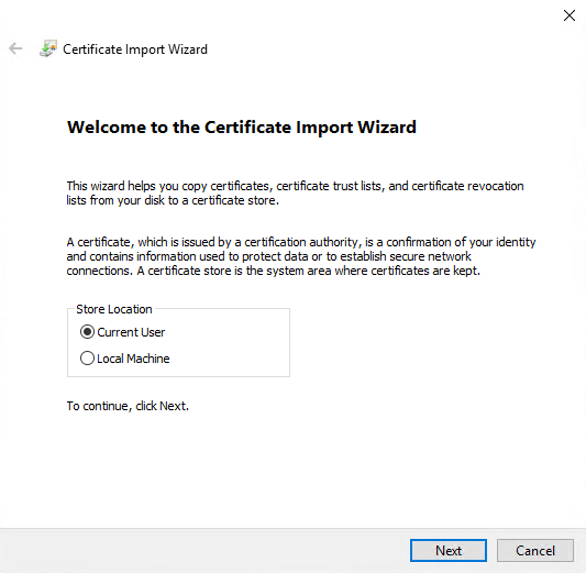

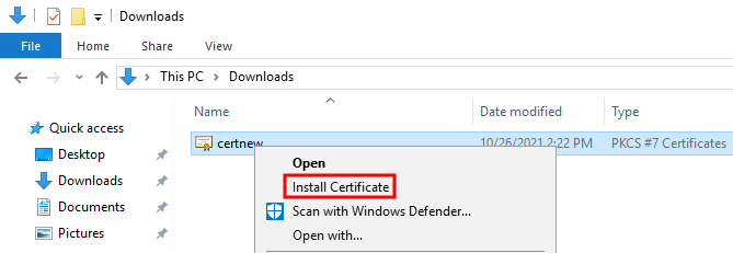

  7. Browse to the downloads folder, right-click the certificate, and select Install Certificate from the shortcut menu.
  8. Accept the security warning if it appears.
    Select to install the certificate for the current user and click Next.
    Import Certificate Wizard

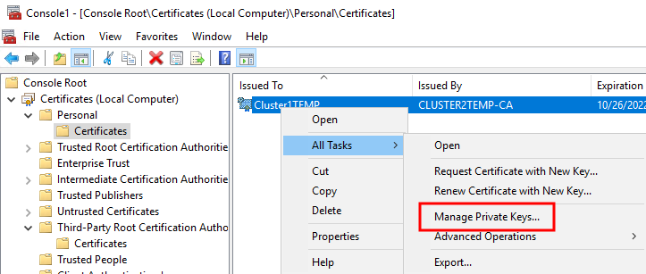

  11. Go to the Microsoft Management Console (MMC) certificates snap-in.

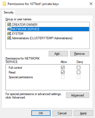

  12. In the console, browse to the personal store where the certificate is installed. Right-click on the certificate and select All Tasks > Manage Private Keys.
    All Tasks > Manage Private Keys...
  13. Add the account that is running the Milestone XProtect Management Server, Recording Server, or Mobile Server software to the list of users with permission to use the certificate.
    Make sure that the user has both Full Control and Read permissions enabled.
    By default, XProtect software uses the NETWORK SERVICE account.
    Add permission for NETWORK SERVICE to use certs
