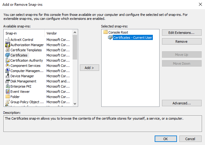

  1. On the computer that hosts the XProtect server, open the Microsoft Management Console.
  2. In the Microsoft Management Console, from the File menu select Add/Remove Snap-in….
  3. Select the Certificates snap-in and click Add.
    Click OK.
    Add the Certificates Snap-in object for the current user.

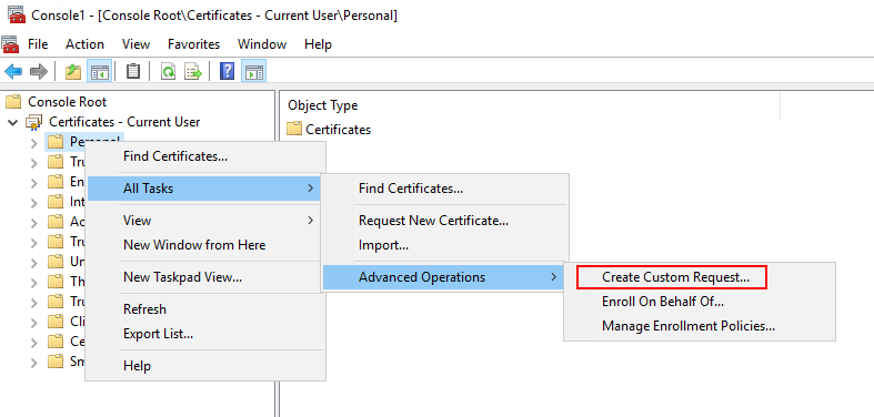

  4. Expand the Certificates object. Right-click on the Personal folder and select All Tasks > Advanced Operations > Create Custom Request.
    Right click Personal certificate store, choose All Tasks > Advanced Operations > Create Custom Request.

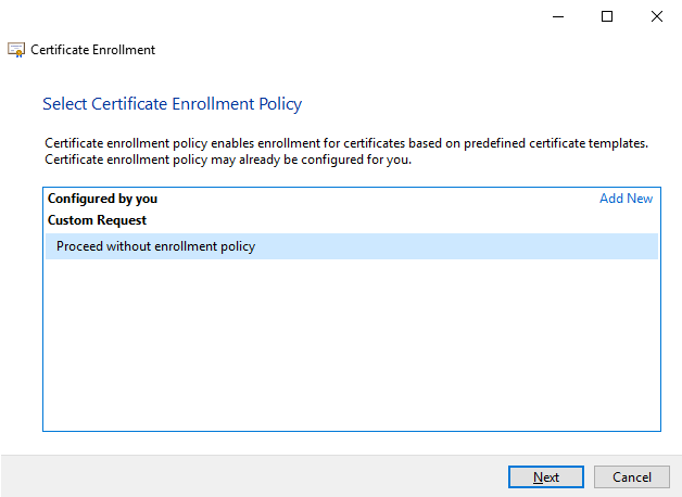

  5. Click Next in the Certificate Enrollment wizard and select Proceed without enrollment policy.
    If your Group Policy already contains a Certificate Enrollment Policy, you will want to confirm the rest of this process with your Domain Administration team before proceeding.
    Click Next.
    Click Next to proceed without enrollment policy

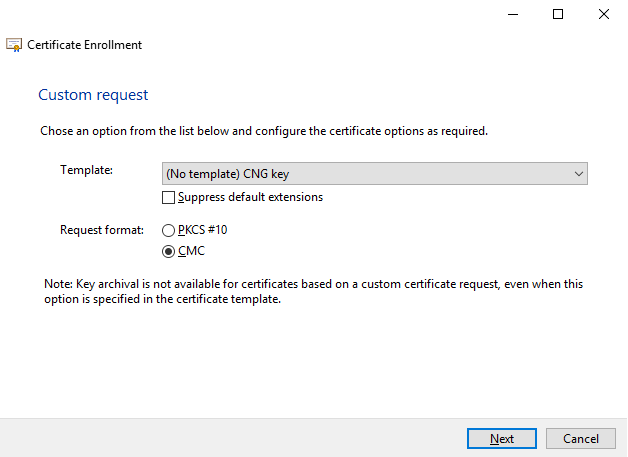

  6. Select the (No template) CNG Key template and the CMC request format, and click Next.
    Keep the default CNG key template and choose the CMC request format. Then click next.

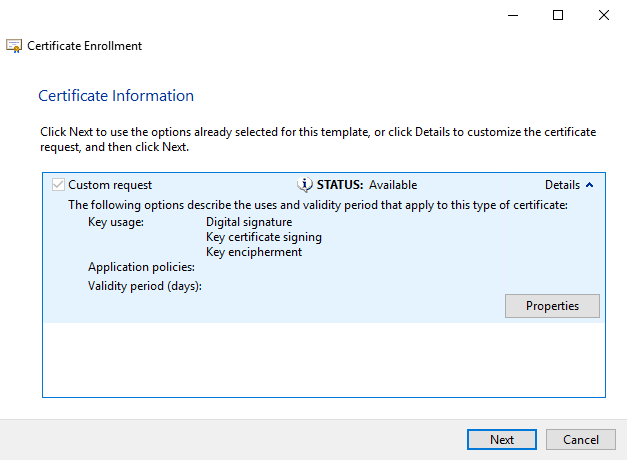

  7. Expand to view the Details of the custom request, and click Properties.
    Click next once all of the properties are defined.

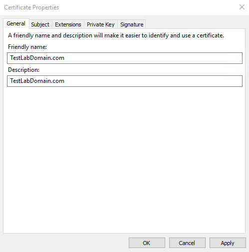

  8. On the General tab, fill in the Friendly name and Description fields with the domain name, computer name, or organization.
    The general tab of the certificate request properties menu.

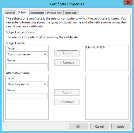

  9. On the Subject tab, enter the required parameters for the subject name.
    In the subject name Type, enter in Common Name the host name of the computer where the certificate will be installed.
    Properties - Subject - Common Name

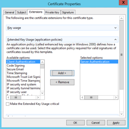

  10. On the Extensions tab and expand the Extended Key Usage (application policies) menu. Add Server Authentication from the list of available options.
    Properties - Extentions - Extended Key Usage - Server Authentication

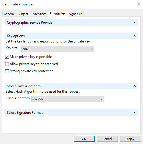

  11. On the Private Key tab, expand the Key options menu.
    Set the key size to 2048 and select the option to make the private key exportable.
    Click OK.
    Certificate Properties window showing the Private Key tab and the selected properties.

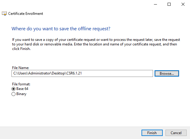

  13. Select a location to save the certificate request and a format. Browse to that location and specify a name for the .req file. The default format is base 64.
  14. Click Finish.
    Final step of certificate request wizard. Define the location and file format.

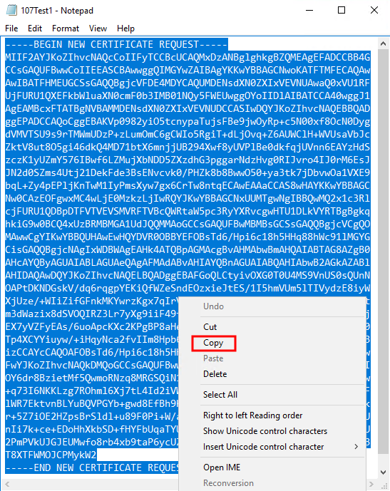

  1. Browse to the location of the .req file and open it in Notepad.
    Copy the entire file contents.
  2. Copy the entire contents of the file. This includes the dashed lines marking the beginning and the end of the Certificate Request.

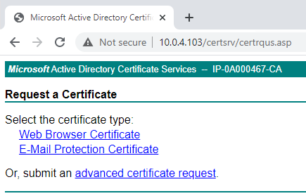

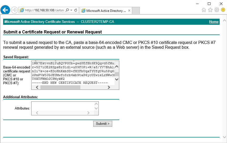

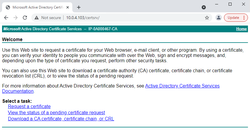

  3. Open a web browser and enter the address of the Domain CA.
    Internal CA site to upload our copied text from the .REQ file.
  4. Click the Request a certificate link.
  5. Click the advanced certificate request link.
    Advanced Certificate Request.
  6. Paste the contents of the .req file into the form. If it is required to select a Certificate Template, select Web Server from the Certificate Template list.
    Paste the entire .req file contents into the form.
  7. Click Submit.

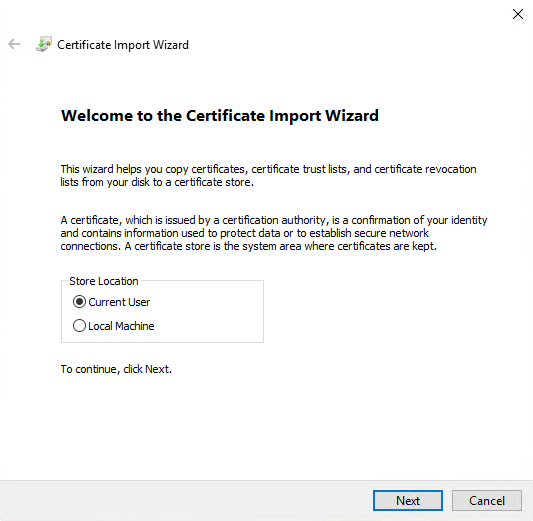

  2. Right-click the certificate and select Install Certificate.
  3. Accept the security warning if it appears.
    Select to install the certificate for the current user and click Next.
    Import Certificate Wizard

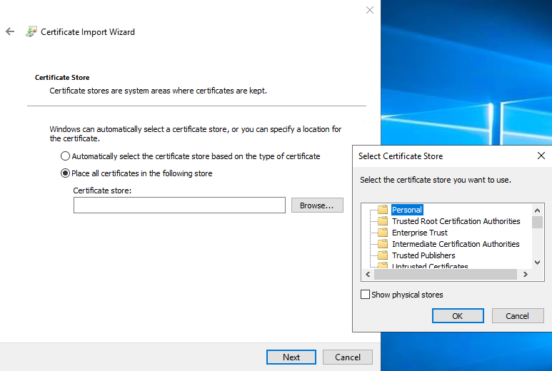

  4. Choose a storage location, and browse to the Personal certificate store, and click Next.
    Choose a custom store - browse - choose the Personal folder.
  5. Finish the Install Certificate wizard.

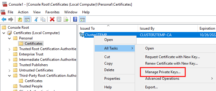

  6. Go to the Microsoft Management Console (MMC) certificates snap-in.
  7. In the console, browse to the personal store where the certificate is installed. Right-click on the certificate and select All Tasks > Manage Private Keys.
    All Tasks > Manage Private Keys...
  8. Verify that the account that is running the Milestone XProtect Management Server, Recording Server, or Mobile Server software is in the list of users with permission to use the certificate.
    Make sure that the user has both Full Control and Read permissions enabled.
    By default, XProtect software uses the NETWORK SERVICE account. In a domain environment, service accounts are commonly used to install and run XProtect services. You will need to discuss this with your Domain Administration team, and have the proper permissions added to the service accounts if it hasn't been configured properly already. Confirm this before proceeding.
