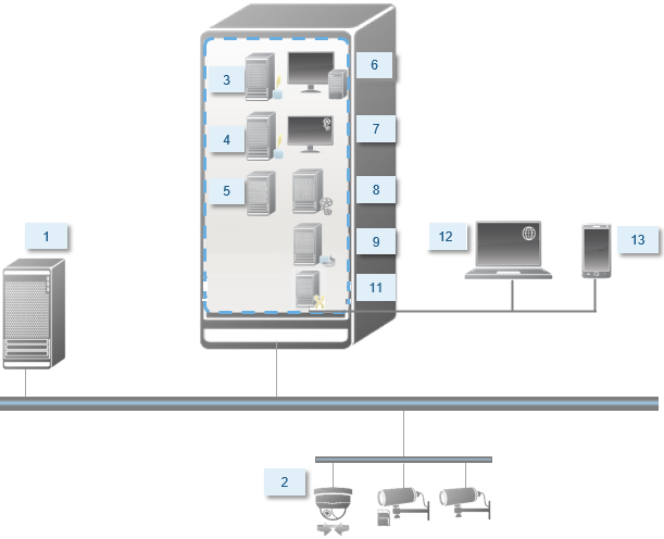

Single Computer installation
Example of a Single Computer installation.
Typical system components in a system:
  1. Active Directory
  2. Devices
  3. Server with SQL Server
  4. Event server
  5. Log server
  6. XProtect Smart Client
  7. Management Client
  8. Management server
  9. Recording server
  10. Failover recording server
  11. XProtect Mobile server
  12. XProtect Web Client
  13. XProtect Mobile client
  14. XProtect Smart Client with XProtect Smart Wall
