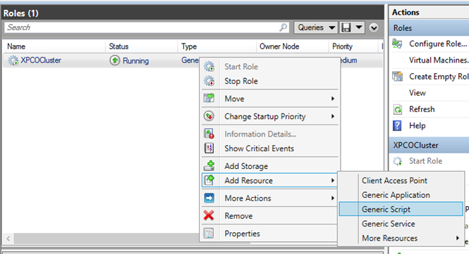

  11. Right-click the role you just created and click Add resourceGeneric Script. Select Milestone XProtect Event Server to add the Milestone XProtect Event Server service as a resource to the Milestone XProtect Management Server Cluster service.
    Add services to the newly created role.

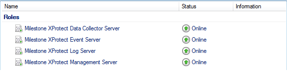

  13. All added services are displayed in the bottom pane of the window.
    List of added services.
