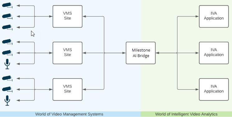

The purpose of Milestone AI Bridge is to make it easy for developers of IVA applications to integrate their solution with the XProtect VMS.
VMS applications and IVA applications cannot communicate directly with each other, but they can through Milestone AI Bridge.
Illustration showing how the XProtect VMS and IVA applications communicate through Milestone AI Bridge.

Most communication and exchange of data between the XProtect VMS and the IVA applications happens through Milestone AI Bridge by using various standard protocols. The only exception is the web page on which you draw the graphical representation of the selected analytics topic. This web page is sent directly from the IVA application to XProtect Management Client.

From the XProtect VMS to IVA applications
The XProtect VMS shares the following camera information with the IVA applications through Milestone AI Bridge:
  • Name and description
  • GPS location and field of view
  • Current communication status (camera online / offline)
  • Available streams and stream properties (among others: codec, resolution, and framerate).
From IVA applications to the XProtect VMS
Through Milestone AI Bridge, the IVA applications send the analytics data back to the XProtect VMS as events, metadata, or video. See also Analytics data types and formats.
