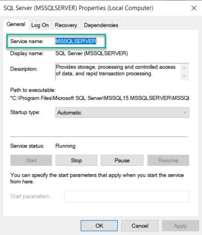

  1. Open the Start menu, and enter services.msc to open Services.
  2. Scroll down to SQL Server [Display name].
  3. Right-click the service and select Properties. On the General tab, the value in the Service name field is the instance name.
