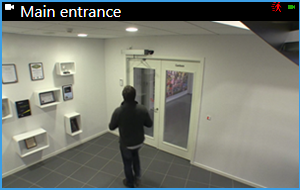

Camera indicators (explained)
The camera indicators show you the status of the video that is displayed in the camera view items. The camera indicators are visible only if the camera title bar is enabled in the Settings window on the Application tab.
The camera title bar in XProtect Smart Client.
You can turn the camera title bar on and off on individual view items. Click Setup and select the Show title bar check box in the Properties pane.
Indicator Description
Motion is detected. Click inside the image to reset the motion indicator.
The server connection to the camera is lost.
Video from the camera is being recorded.
A connection to the camera is established. This icon is only relevant for live video.
Playing back recorded video.
No new images have been received from the server for more than two seconds.
In the camera properties, you can add sound to notify you when there is motion.
