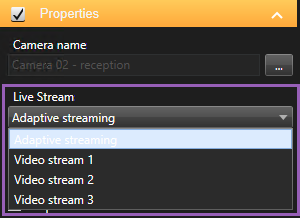

To make sure that Adaptive streaming is configured in a view:
  1. Click Setup to configure the view.
  2. In Properties, click the Live stream dropdown list, and the list of available live video streams appears.
  3. Check if two or more live video streams are available and select Adaptive streaming.
    Verify that adaptive streaming is selected in the camera properties.
    If only one live video stream is available, add more live video streams for the camera in XProtect Management Client.
  4. Click Setup to close the view configuration.

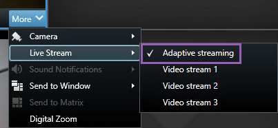

To make sure that Adaptive streaming is selected in a Live view item:
  1. Click the More dropdown list.
  2. Select Live stream, and the list of available live video streams appears.
    Verify that adaptive streaming is selected in the camera view item.
