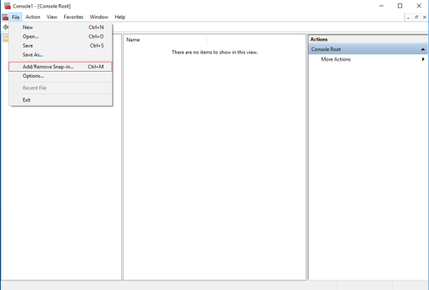

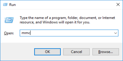

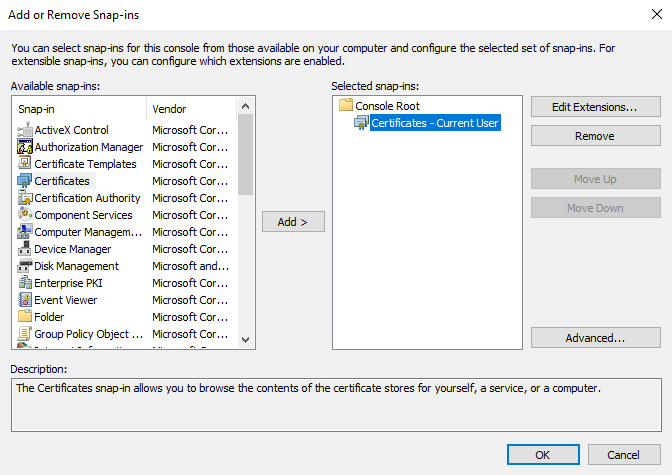

  1. On the computer that hosts the Mobile Server, open the Microsoft Management Console.
  2. In the Microsoft Management Console, from the File menu select Add/Remove Snap-in….
  3. Select the Certificates snap-in and click Add.
    Click OK.
    Add the Certificates Snap-in object for the current user.

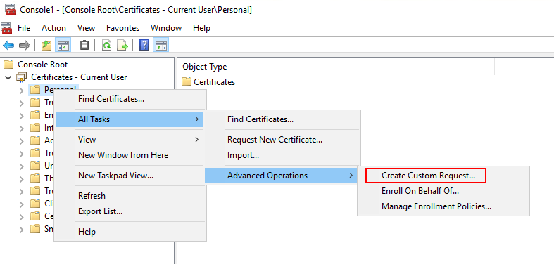

  4. Expand the Certificates object. Right-click on the Personal folder and select All Tasks > Advanced Operations > Create Custom Request.
    Right click Personal certificate store, choose All Tasks > Advanced Operations > Create Custom Request.

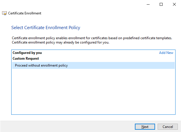

  5. Click Next in the Certificate Enrollment wizard and select Proceed without enrollment policy.
    Click Next.
    Click Next to proceed without enrollment policy

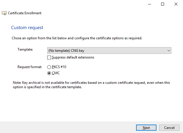

  6. Select the (No template) CNG Key template and the CMC request format, and click Next.
    Keep the default CNG key template and choose the CMC request format. Then click next.
    The request format depends on the CA. If the wrong format is chosen, the CA will issue an error when the certificate signing request (CSR) is submitted. Check with the CA to make sure you choose properly.

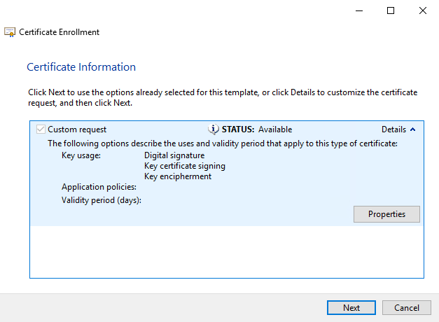

  7. Expand to view the Details of the custom request, and click Properties.

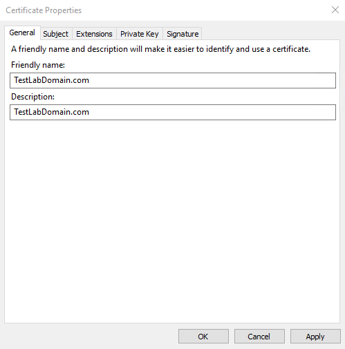

  8. On the General tab, fill in the Friendly name and Description fields with the domain name registered with the CA.
    The general tab of the certificate request properties menu.

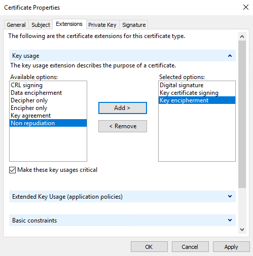

  10. Some CAs don't require extensions. However, if required, go to the Extensions tab and expand the Key usage menu. Add the required options from the list of Available options to the Selected options list.
    Key usage options in the Extension tab of the Certificate properties menu.

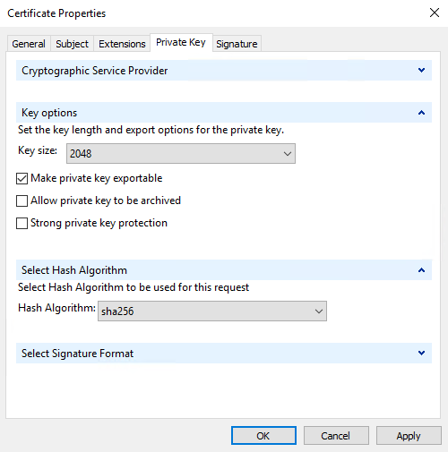

  11. On the Private Key tab, expand the Key options menu.
    Set the key size to 2048 and select the option to make the private key exportable.
    The key size variable is determined by the CA, therefore a higher size key may be required. Other options, such as a specific Hash Algorithm (sha256), may also be required. Adjust all of the options required before proceeding to the next step.
    Certificate Properties window showing the Private Key tab and the selected properties.

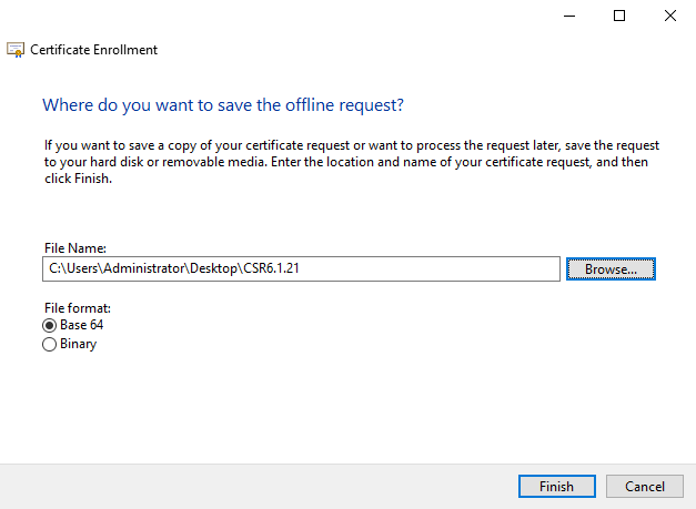

  14. Select a location to save the certificate request and a format. Browse to that location and specify a name for the .req file. The default format is base 64, however some CAs require the binary format.
  15. Click Finish.
    Final step of certificate request wizard. Define the location and file format.

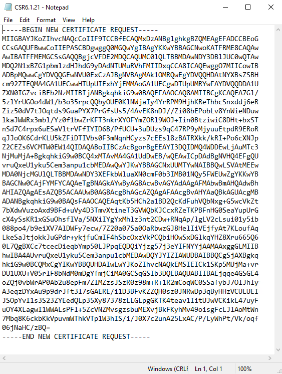

Your CA will need the contents of the .req file. You will be asked to copy the entire text of the .req file, including the begin and end lines, and paste the text into a field made available at a portal managed by the CA.
  1. Browse to the location of the .req file and open it in Notepad, and paste the text into a field made available at a portal managed by your CA.
    Copy the entire contents of the text file, including the begin and end statements.

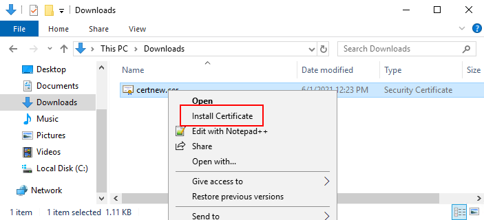

  2. When you receive the certificate from your CA, browse to the downloads folder (or wherever you choose to store the folder on the computer), right-click the certificate and select Install Certificate.
    Right click the certificate in the downloads folder and choose Install Certificate from the shortcut menu.

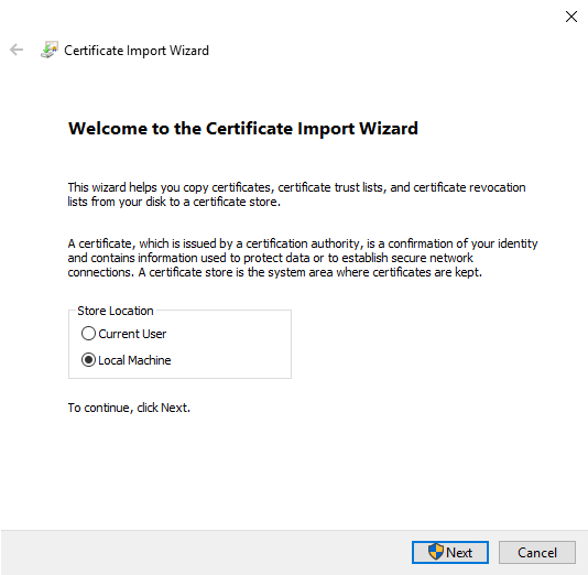

    Select to install the certificate for the local machine and click Next.
    Choose to install the certificate on the Local Machine store.

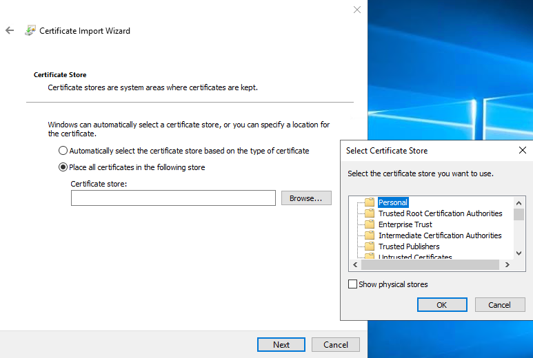

  4. Choose a storage location, and browse to the Personal certificate store, and click Next.
    Choose a custom store - browse - choose the Personal folder.
