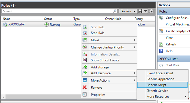

  11. Right-click the role you just created and click Add resourceGeneric Script. Select Milestone XProtect Event Server to add the Milestone XProtect Event Server service as a resource to the Milestone XProtect Management Server Cluster service.
    Add services to the newly created role.

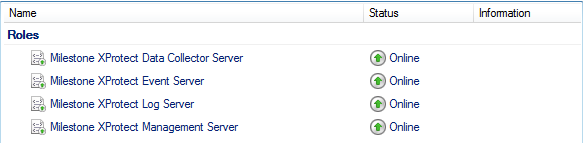

  12. Repeat step 11 and add all required services in the cluster, for example the Log Server. The Milestone XProtect Event Server and the Data Collector server should both be added as services to achieve an optimal deployment. Additionally, the Milestone XProtect Event Server should be set as a dependent service of the management server to ensure the event server also will stop when the management server is stopped.
  13. All added services are displayed in the bottom pane of the window.
    List of added services.

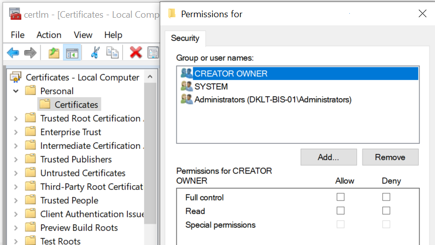

Check permissions to a certificate private key:
  1. Select Start on the Windows task bar and open the Manage computer certificates tool (certlm.msc).
  2. Navigate to the personal certificate store and find the certificate that is used for the encryption.
  3. Right-click on the certificate, and select All Tasks > Manage Private Keys.
  4. Under Permissions for, ensure that the Identity Provider app pool (IDP) account has read permissions.
