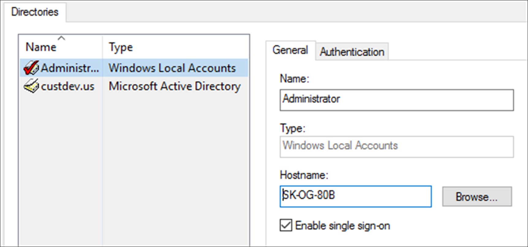

  1. Choose the directory type, either Windows Local Account or domain user account.
    For Windows Local Account support, the single sign-on account MUST be a Windows Local Account.

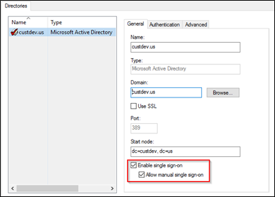

    For Domain User Account support, the single sign-on account MUST Allow manual single sign-on as shown below.
If you are creating a Directory of a type other than Windows Local Accounts (e.g. LDAP, Active Directory), ensure that the SSO user is a member of the Local Administrators group.
