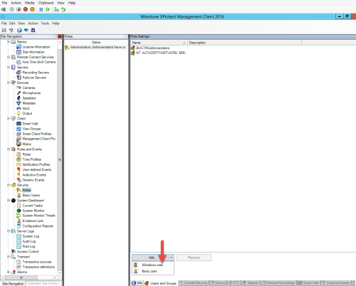

To add Windows users or groups to roles in Management Client, follow these steps:
  1. Open Management Client.
  2. Expand the Security node.
  3. Select the role to which you want to add the Windows users.
  4. On the Users and Groups tab, click Add, and select Windows user. A pop-up window appears.
  5. If the domain name does not appear in the From this location field, click Locations.
  6. Specify the Windows user, and then click OK.
To verify that the Windows user is an AD user, the domain name must appear as a prefix, for example "Domain\John".

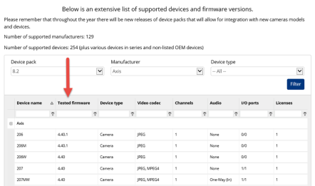

    Keep software and device firmware updated
    Milestone recommends that you use the latest version of XProtect VMS and firmware for the hardware devices, for example the cameras. This will ensure that your system includes the latest security fixes.
    For hardware, network components, and operating systems, check the CVE database as well as any updates pushed out by manufacturers.
    Before you upgrade the device firmware, verify that XProtect VMS supports it. Also, make sure that the device pack installed on the recording servers supports the device firmware.
    Do this in a test environment for configuration, integration and testing before putting it into the production environment.
    To verify that the VMS supports a device, follow these steps:
    1. Open this link (https://www.milestonesys.com/da/community/business-partner-tools/supported-devices/).
    2. Click the link that matches your XProtect VMS product.
    3. In the Device pack column, select the version of the current device pack.
    4. Select the manufacturer of your device, and then click Filter. The version of the firmware that the device pack supports is listed in the Tested Firmware column.

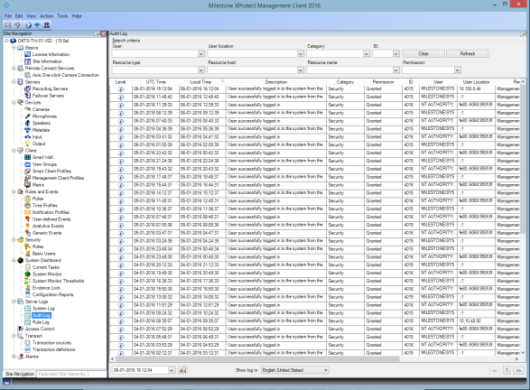

    Monitor logs in the VMS for signs of suspicious activity
    XProtect VMS provides features for generating and viewing logs that provide information about patterns of use, system performance, and other issues.Milestone recommends that you monitor the logs for signs of suspicious activities.
    There are tools that leverage logs for operational and security purposes. Many businesses use syslog servers to consolidate logs. You can use syslog to note activities at a Windows level, however, XProtect VMS does not support syslog.
    Milestone recommends that you use the Audit Log in XProtect VMS, and enable user access logging in Management Client. By default, the Audit Log notes only user logins. However, you can turn on user access logging so that the Audit Log notes all user activities in all of the client components of XProtect VMS products. This includes the times of the activities and the source IP addresses.
    The client components are XProtect Smart Client, Web Client, and the XProtect Management Client component, and also integrations made by using the MIP SDK. Examples of activities are exports, activating outputs, viewing cameras live or in playback, and so on.
    The Audit log does not note unsuccessful login attempts, or when the user logs out.
    Logging all user activities in all clients increases the load on the system, and can affect performance.
    You can adjust the load by specifying the following criteria that controls when the system will generate a log entry:
    • The number of seconds that comprise one sequence. The VMS generates one log entry when a user plays video within the sequence.
    • The number of frames that a user must view when playing back video before the VMS generates a log entry.
    To turn on and configure extended user access logging, follow these steps:
    1. In Management Client, click Tools, and select Options.
    2. On the Server Logs tab, under Log settings, select Audit Log.
    3. Under Settings, select the Enable user access logging check box.
    4. Optional: To specify limitations for the information that is noted, and reduce impact on performance, make selections in the Playback sequence logging length and Records seen before logging fields.
    To view the Audit Log in XProtect VMS, follow these steps:
    2. Expand the Server Logs node.
    3. Click Audit Log.
