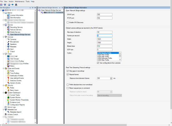

Open the Management Client and select the Milestone Open Network Bridges node.
Open Network Bridge Information pane in the Milestone Open Network Bridge node.
Milestone Open Network Bridge settings
The following table describes the settings for the Milestone Open Network Bridge server and ONVIF clients.
When these settings are changed, for them to take effect, Milestone Open Network Bridge server must be restarted.
Name
Description
ONVIF port
The port number of the ONVIF port. ONVIF clients use this port to connect to the Milestone Open Network Bridge server.
The default port number is 580.
RTSP port
The port number of the RTSP port. The Milestone Open Network Bridge server sends RTSP video streams through this port to ONVIF clients.
The default port number is 554.
Enable WS-Discovery
WS-Discovery (Web Services Dynamic Discovery) is a technical specification that defines a multicast discovery protocol to locate services on a local network.
Default camera settings (as reported to the ONVIF clients)
These settings for the Milestone Open Network Bridge list the default settings for all cameras that the Milestone Open Network Bridge provides to the ONVIF clients when the clients connect and request video streams.
The settings do not reflect the actual configuration of the cameras, and do not affect the video stream. The system uses the settings to speed up the exchange of video between the Milestone Open Network Bridge and the ONVIF client. The ONVIF client will use the actual settings from the RTSP stream.
You can change the default settings that Milestone Open Network Bridge provides to the ONVIF client, for example, if you want the values to reflect the actual configuration of the cameras.
Name
Description
Max days of retention
Default value is 30.
Frame per seconds
Default value is 5.
Width
Default value is 1920. This corresponds to full HD quality.
Height
Default value is 1080. This corresponds to full HD quality.
Bitrate Kbps
Default value is 512.
GOP size
Default value is 5.
Codec
Select one of the H.264 or H.265 codec profiles. The default value is H.264 Baseline Profile.
Use configurations from cameras
Default is enabled. Enable this to use the actual configuration of the cameras instead of the default average values defined above.
If you enable this setting, the response time between the XProtect system and the ONVIF clients may increase.
Real time Streaming Protocol settings
Name
Description
Skip gaps in recordings
When the client performs RTSP playback of recorded video, if there are gaps in the recordings, they will be omitted during playback.
This is enabled by default.
Repeat frames
Some players do not behave well when the distance between frames is more than 500 ms. This setting repeats individual frames and adjusts the timestamp, so that when played the video appears to have more frames.
Maximum time between frames: defines the time in milliseconds between frames.
Prefer absolute time over normalized
This setting defines the RTSP server playback response, where the client’s time interval for playback is not specified.
Select this option if you want your RTSP server to use real time as opposed to scaled or normalized playback.
However, if your client application is set to use either relative time intervals or real time intervals (in UTC), the RTSP server replies with those intervals defined in the client.
Return sequences on command
Enable this to return information for sequences on the DESCRIBE command response.
Maximum number to return
Set the maximum number of sequences to be sent to the client. Default value is 10.
Return from start or end of recording
Select from where to start searching the sequences. from the start or from the end of the recording.
