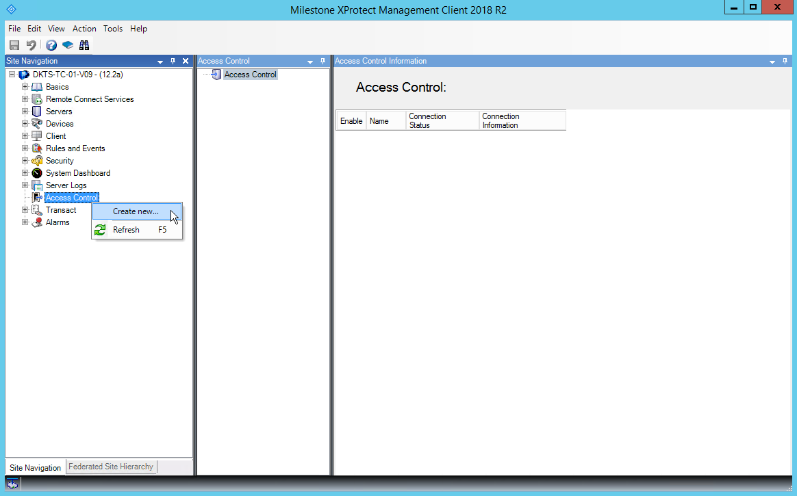

Screenshot of: XProtect Management Client > Site Navigation > Access Control > Create new
In your Management Client or Management Application:
  1. Right-click Access Control.
  2. Select Create new to create a new integration. A dialog box appears.

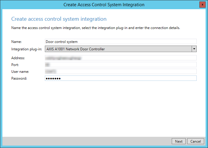

The Create access control system integration dialog box. Here, enter the name of the integration and the connection details, such as the address, port, user name, password.
In the Create access control system integration dialog box:
  1. In the Name field, enter a name for your access control system.
  2. In the Integration plug-in field, select AXIS A1001 Network Door Controller.
  3. In the Address field, enter the network address of your AXIS A1001 system.
    If your system is connected to more than one AXIS A1001 system, select one connection to represent your whole system.
  4. In the Port field, enter the network port for your AXIS A1001 system.
  5. In the User name and Password fields, enter your login information.
    In a system with multiple connected AXIS A1001 systems, the same user name and password will be used for all controllers in the system.
  6. Select Next.

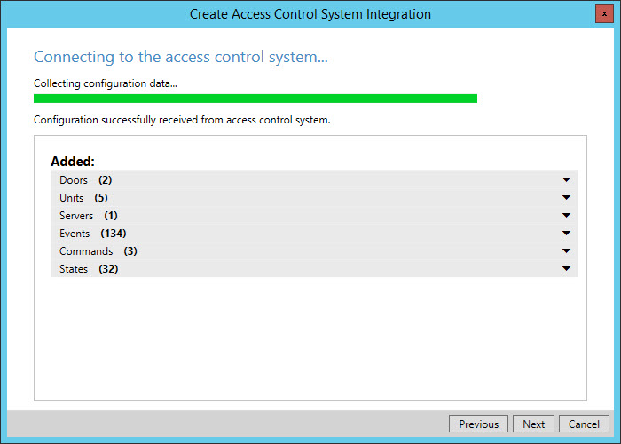

The Connecting to the access control system dialog box is collecting configuration data, such as doors, units, servers, events, commands, and states.
In the Connecting to the access control system dialog box, your XProtect Event Server collects doors and other entities. Select Next.

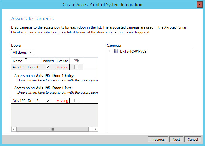

The Associate cameras dialog box. In the Cameras pane, select a camera and drag it to an access point in the Doors pane.
In the Associate cameras dialog box:
  1. In the Cameras pane, select a camera and drag it to an access point in the Doors pane.
    This step is optional. You can make and change camera associations later.
  2. Select Next to complete the integration.
The AXIS A1001 plug-in is now integrated with your XProtect Event Server, and the XProtect Access functionality is enabled in the XProtect VMS system.
