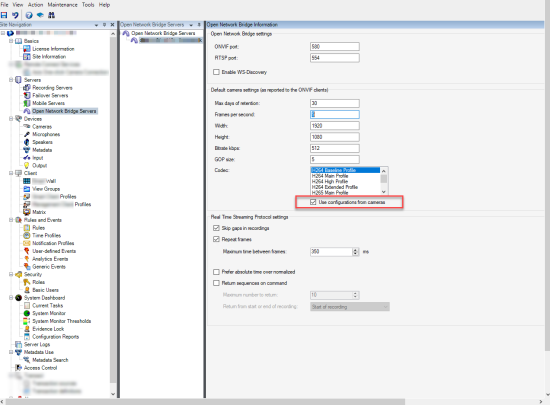

You can get an overview of all recorded video available on the device by using the GetRecordingSummary command. This is not required, but it provides useful information prior to conducting a search.
You can use GetRecordingSummary and/or GetMediaAttributes to get the timestamp of the first and the last recording, but you must first enable the Use configurations from cameras setting on the Milestone Open Network Bridge plug-in in the XProtect Management Client.
Use configuration from cameras check box in the Open Network Bridge Information pane.
