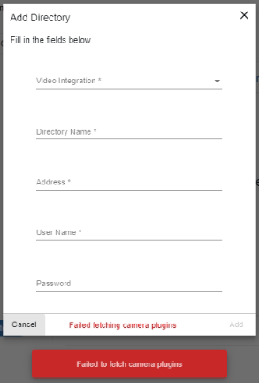

Failed fetching camera plugins error
Symptom
In the Camera management section of the BriefCam Administrator Console when trying to add a directory, the Milestone Integration option is not available and the Failed fetching camera plugins error appears at the bottom of the screen.

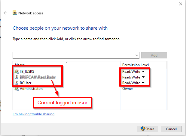

  1. Check the Data folder for sufficient permissions. The current logged in user should have read/write permissions.

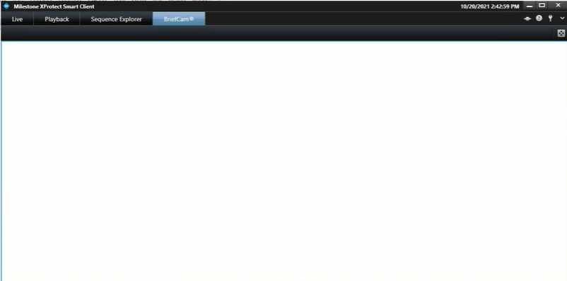

White screen displayed
Symptom
XPRR was installed without any errors. However, the embedded client shows a white/blank screen.

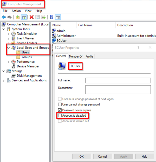

Note that by default the user who runs the BriefCam services is the BCUser. You may still see the white screen issue if the user configured as BCUser was disabled, for example, after moving to a domain. To solve this issue:
  1. From the Windows Services, try restarting the BriefCam VSService.
  2. If the service fails to start, then check the BCUser settings in the Computer Management console.

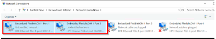

Two NICs
The white screen might display if either the BriefCam server of Milestone smart client computer has two NICs (network interfaces) are attached to it and the SSO communication looks for the local host.
As a result, there are issues loading BriefCam’s iFrame in the Milestone embedded client.
  1. Check how many activated NICs exist, by going to Control Panel > Network and Sharing Center > Change adapter settings.
  1. If there is more than one NIC activated, if possible, inactivate one of the NICs.

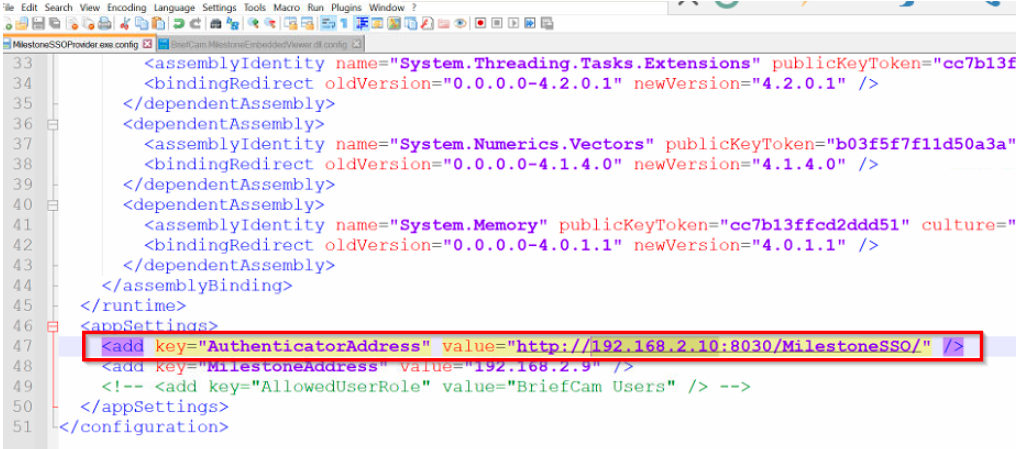

  1. On the BriefCam server, open the Milestone SSOProvider.exe.config file (located at: C:\Program Files\BriefCam\BriefCam Server) and find the AuthenticatorAddress value.
  2. If the value is set to localhost, change the value to point to theMilestone server’s IP address.
The MilestoneSSOProvider.log file is located at C:\Program Files\BriefCam\BriefCam Server\logs\MilestoneSSOProvider-0.

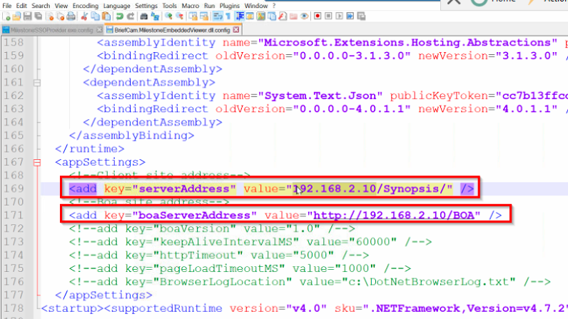

  3. In the BriefCam.MilestoneEmbeddedViewer.dll.config file (located at: C:\Program Files\Milestone\XProtect Smart Client\MIPPlugins\BriefCam), both the serverAddress and the boaServer address need to point to the BriefCam server. If there is more than one NIC, use the IP address of the BriefCam server. Below are detailed instructions of how to do this:
    1. Scroll to the bottom of the file and look for the following lines: <add key=”serverAddress” value=”http://computer’s_hostname/synopsis/” />
    2. Change the values to match your BriefCam server (the XPRR Computer). For example, if the BriefCam XPRR computer is called RapRev, the value will look as follows:  http://RapRev/synopsis/
    3. Find this row: <add key=”boaServerAddress” value=”http://cmputer’s_hostname/BOA/” />
    4. Change the value point to your Milestone server. For example: http://RapRev/BOA/

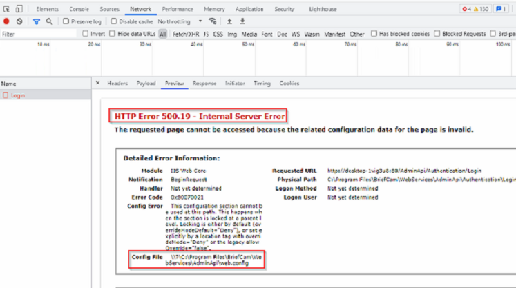

After installing BriefCam and trying to open the BriefCam Administrator Console, a Server Unavailable error appears. When opening F12 (debug mode), the following is seen:
Possible root causes
  • BriefCam and Milestone are installed on the same computer, which causes the IIS services to conflict since the same ports are in use. As detailed in the prerequisites, a dedicated machine for BriefCam is required.
  • The IIS components are not configured on the current server. This may be because of a custom operating system image that includes certain restrictions, such as the IIS is not installed, only a restricted list of components was installed, or the Sysadmin restricted those components to be installed/configured by external installers.

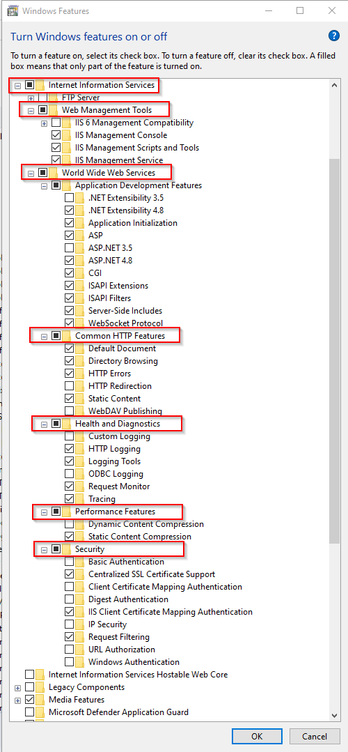

  1. From the Windows Control Panel, open Programs and Features.
  1. Click Turn Windows features on or off.
  2. From the list, make sure that all the Internet Information Services that appear in the illustration below are available.
  3. If a service is missing, add it, and restart the computer
