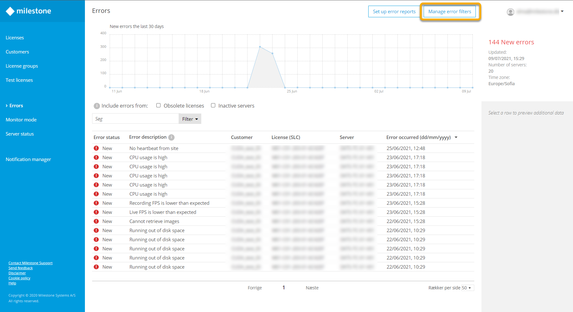

- Select Errors in the main menu, then select Manage error filters.
The created error filters for your customers will be displayed on the Manage error filters screen.

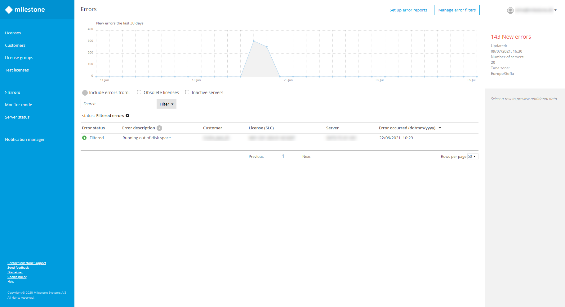

You can see all filtered errors by selecting Filter > Filtered Errors from the Errors page.

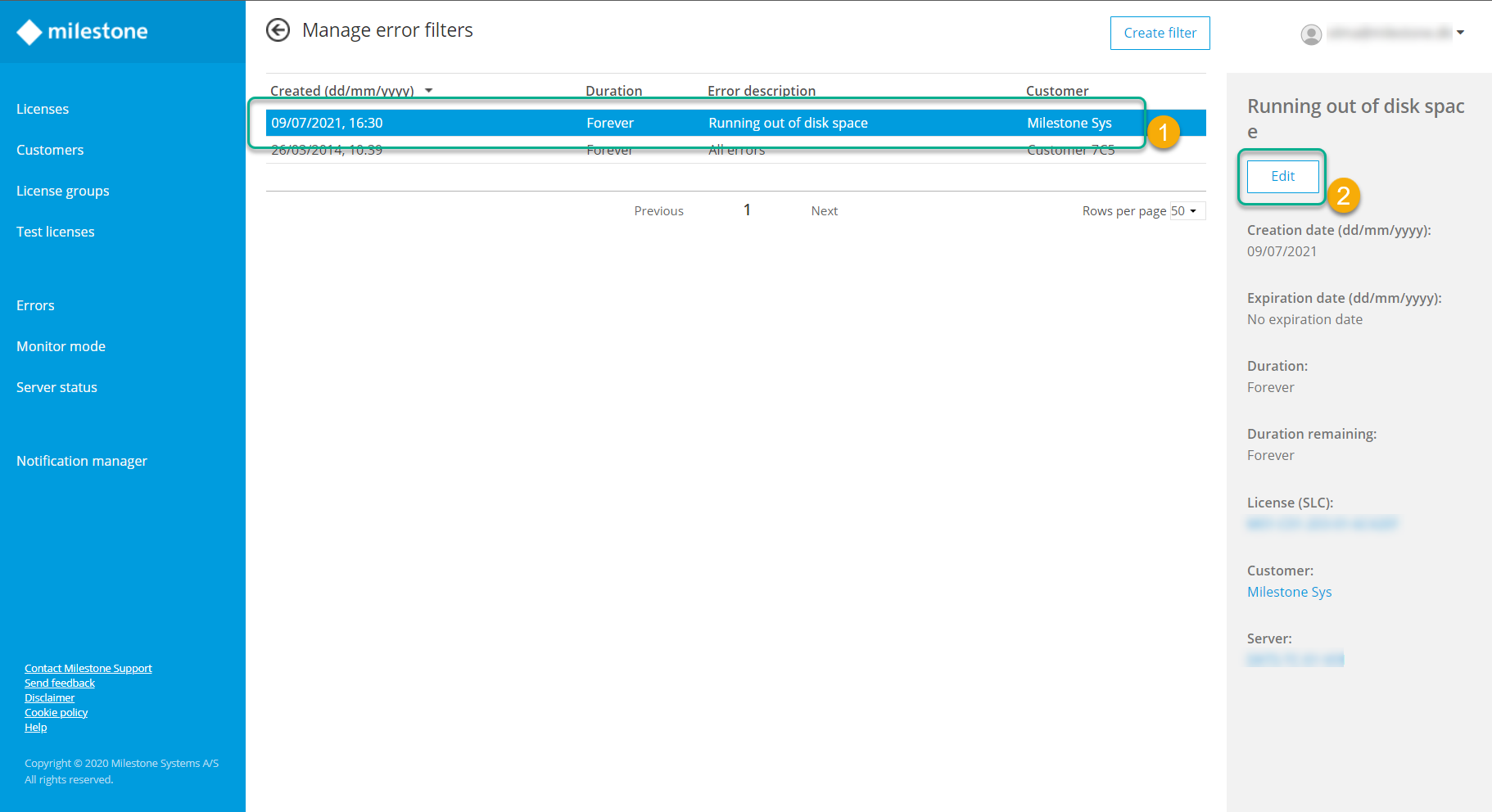

To edit a filter:
In the navigation pane, select Errors and then click Manage error filters.
Select an existing filter
and click Edit

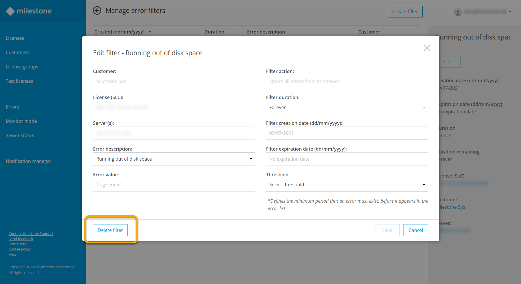

To delete a filter:
In the navigation pane, select Errors, then click Manage error filters.
and click Edit
Select Delete filter.
The error filter is removed and cannot be restored.
