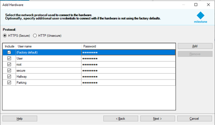

- Devices are connected over HTTPS and on either Secure Real-Time Transport Protocol (SRTP) or Real Time Streaming Protocol (RTSP) over HTTPS for the video stream
Driver modules cannot guarantee FIPS 140-2 compliance of a connection over HTTP. The connection may be compliant, but there is no guarantee that it is in fact compliant.

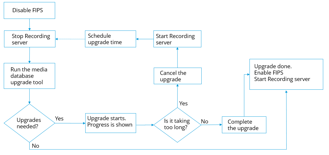

What is the media conversion tool?
The media conversion tool is a stand-alone PowerShell script, that is delivered in source. It is not part of any installation.
It is to be distributed to customers only through Milestone support.
It can convert all storage in bulk, or it can be run on a specific storage.
Progress indicators show how far the tool has gotten.
If the conversion takes too long, you can cancel the job and continue without FIPS enabled.
The media conversion tool converts encrypted credentials inside existing media table files to the newest format that is FIPS compatible.
The media conversion tool does not change the encryption of the video data itself. If the video data is encrypted with a non-compliant algorithm (DES), the updated tables will load, but video will be inaccessible in FIPS compliant mode.
The media conversion tool converts and checks if all tables are using FIPS compliant algorithms.
Approved tables will be marked to eliminate them from being checked by media conversion tool again.
After running the media conversion tool, the XProtect VMS 2020 R3 will be able to load tables in FIPS compliant mode.
Media conversion tool workflow
Media database upgrade: XProtect VMS 2020 R1 or XProtect VMS 2020 R2
If you are running XProtect VMS version 2020 R1 or XProtect VMS 2020 R2, media data that is recorded with one of these versions will be automatically re-encrypted with FIPS 140-2 compliant algorithms during the recording server upgrade.

Encrypt hardware detection passwords
The hardware detection passwords must be updated after you upgrade to XProtect VMS 2020 R3.
The encryption of the hardware detection passwords is not updated during upgrade from earlier version of XProtect VMS. But, these passwords cannot be read if the FIPS Group Policy flag is enabled in Windows.

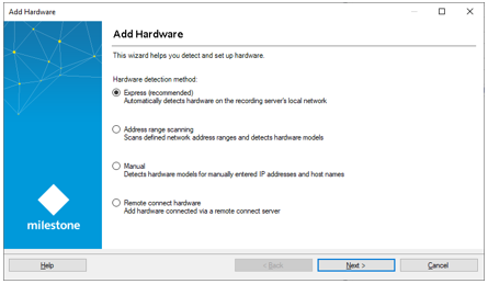

You must trigger a conversion of these passwords before you enable FIPS. Do the following:
- Make sure the FIPS Group Policy flag is disabled in Windows.
- In XProtect Management Client, open the Add Hardware wizard.
- Select the detection method to open the hardware detection page.
This triggers the re-encryption of the hardware detection passwords with FIPS-compliant algorithms.
The credentials are now encrypted with FIPS-compliant algorithms.
