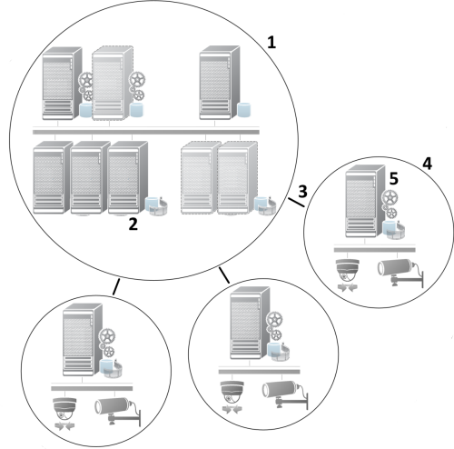

Milestone Interconnect™ allows you to integrate a number of smaller, physically fragmented, and remote XProtect installations with one XProtect Corporate central site. You can install these smaller sites, called remote sites, on mobile units, for example, boats, busses or trains. This means that such sites do not need to be permanently connected to a network.
The following illustration shows how you could set up Milestone Interconnect on your system:
An Illustration of a possible Milestone Interconnect setup.
  1. Milestone Interconnect central XProtect Corporate site
  2. Milestone Interconnect drivers (handles the connection between the central sites' recording servers and the remote site, must be selected in the list of drivers when adding remote systems via the Add Hardware wizard)
  3. Milestone Interconnect connection
  4. Milestone Interconnect remote site (the complete remote site with system installation, users, cameras and so on)
  5. Milestone Interconnect remote system (the actual technical installation at the remote site)
You add remote sites to your central site with the Add Hardware wizard from the central site (see Add a remote site to your central Milestone Interconnect site).
