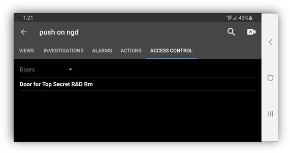

After logging into the VMS with Milestone Mobile the Views tab is presented by default. From this tab it is possible to select the Access Control tab. The Access Control tab shows the list of doors available.

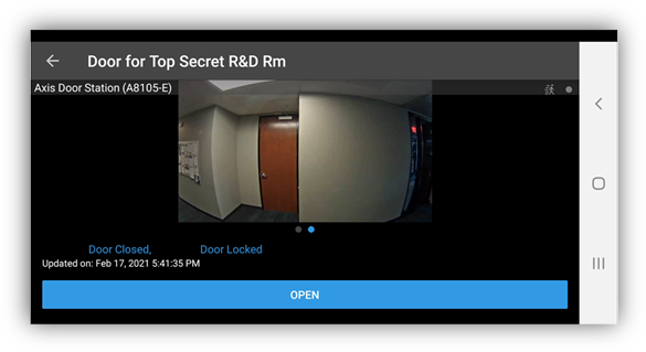

Filter for specific doors or select a door to view cameras associated to that door or interact with commands available for the selected door. Swipe to switch between cameras when multiple cameras are associated to a door.

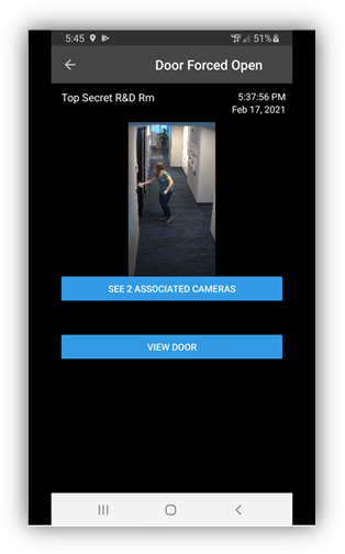

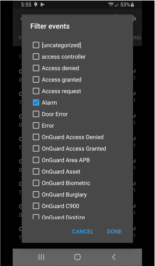

Switch between Doors, Events, and Access Requests. Select an event from the event list to view still images associated to the event and playback video related to the event. Filter the event list.
