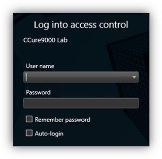

Smart Client personalized login
A second login into the access control dialog is required. It occurs immediately after the standard Smart Client login dialog.
After entering the user name and password, XProtect will attempt to validate the credentials against the CCure 9000 system. If Skip this step is selected, the Smart Client is opened without using personalized login, and no XPA features are available in the Smart Client. After authentication with CCure 9000, Smart Client loads a personalized configuration. The Smart Client will only display access control information from the user account that logged in during the personalized configuration login dialog. This includes:
