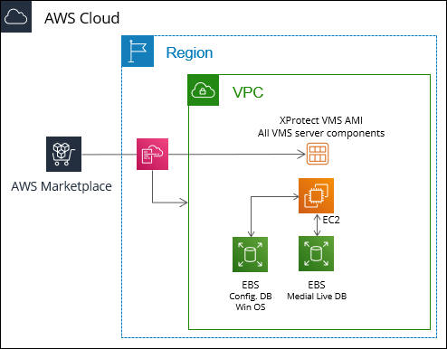

The XProtect BYOL CloudFormation stack includes a Virtual Private Cloud (VPC) and the required AWS services to create a cloud-based VMS deployment. The XProtect BYOL CloudFormation template uses a custom Amazon Machine Image (AMI) to configure and deploy the XProtect VMS on an Elastic Compute Cloud (EC2) instance.
The XProtect BYOL CloudFormation template deploys two Elastic Block Storage (EBS) volumes. The first volume contains the Windows Server 2019 operating system, the XProtect VMS software, and Microsoft SQL Server Express database that contains VMS logs and configuration entries. The second volume contains a live media database for your video recordings. Both volumes use the gp2 EBS volume type to meet the storage performance and redundancy level that your XProtect system requires.

Operating System volume (Disk 0) | Media Database volume (Disk 1) |
Windows operating system | XProtect Media database |
XProtect software |
Database optimized for recording and storing audio and video data from your connected cameras and devices (recordings) The default video recording retention time (1 week) can be increased in Management Client after deployment For optimal performance, Milestone recommends that you set video retention to one day and use FSx for archive storage. For more information, see system scaling. |
Microsoft SQL Server Express database Holds the XProtect configuration, logs and events |
