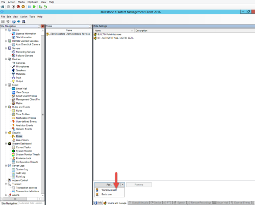

To add Windows users or groups to roles in Management Client, follow these steps:
  1. Open Management Client.
  2. Expand the Security node.
  3. Select the role to which you want to add the Windows users.
  4. On the Users and Groups tab, click Add, and select Windows user. A pop-up window appears.
  5. If the domain name does not appear in the From this location field, click Locations.
  6. Specify the Windows user, and then click OK.
To verify that the Windows user is an AD user, the domain name must appear as a prefix, for example "Domain\John".

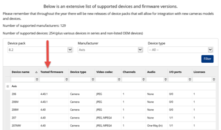

    To verify that the VMS supports a device, follow these steps:
    1. Open this link (https://www.milestonesys.com/da/community/business-partner-tools/supported-devices/).
    2. Click the link that matches your XProtect VMS product.
    3. In the Device pack column, select the version of the current device pack.
    4. Select the manufacturer of your device, and then click Filter. The version of the firmware that the device pack supports is listed in the Tested Firmware column.

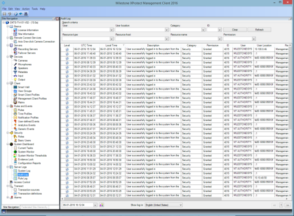

    To view the Audit Log in XProtect VMS, follow these steps:
    2. Expand the Server Logs node.
    3. Click Audit Log.
