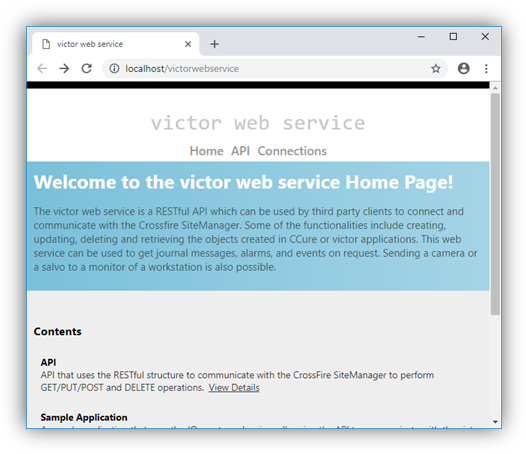

  • If the browser opens a page similar to the one below, everything is okay with the victor web service

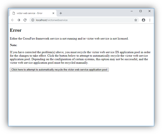

  • If the browser leads to an error message similar to the one seen below, click the button shown on the page to recycle the victor web service application pool
