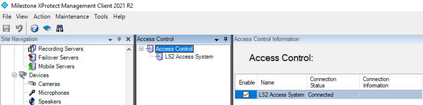

XPA instance status & properties
Go to the Access Control menu in the directory tree of the XProtect Management Client. You can check the status of all instances by selecting the root of the Access Control directory.
Click on your OnGuard XPA instance to view or modify the properties of the connection.
Below, the properties are listed.

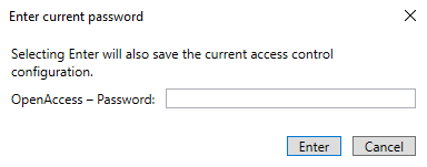

OpenAccess – Password: |
The password of an OnGuard user which is used to log into the OnGuardOpenAccess web service. In XProtect versions 2021 R1 forward, after the password is entered correctly in the XPA instance creation wizard, this field is replaced by the “Enter current password…” button in the General Settings tab. If the SSO user account is changed to modify the integrated hardware device set, or the current user’s password needs to be updated - click the button to open a dialog box which allows the password to be changed.

You can verify that the integration module is now connected by looking at the Access Control tree.
