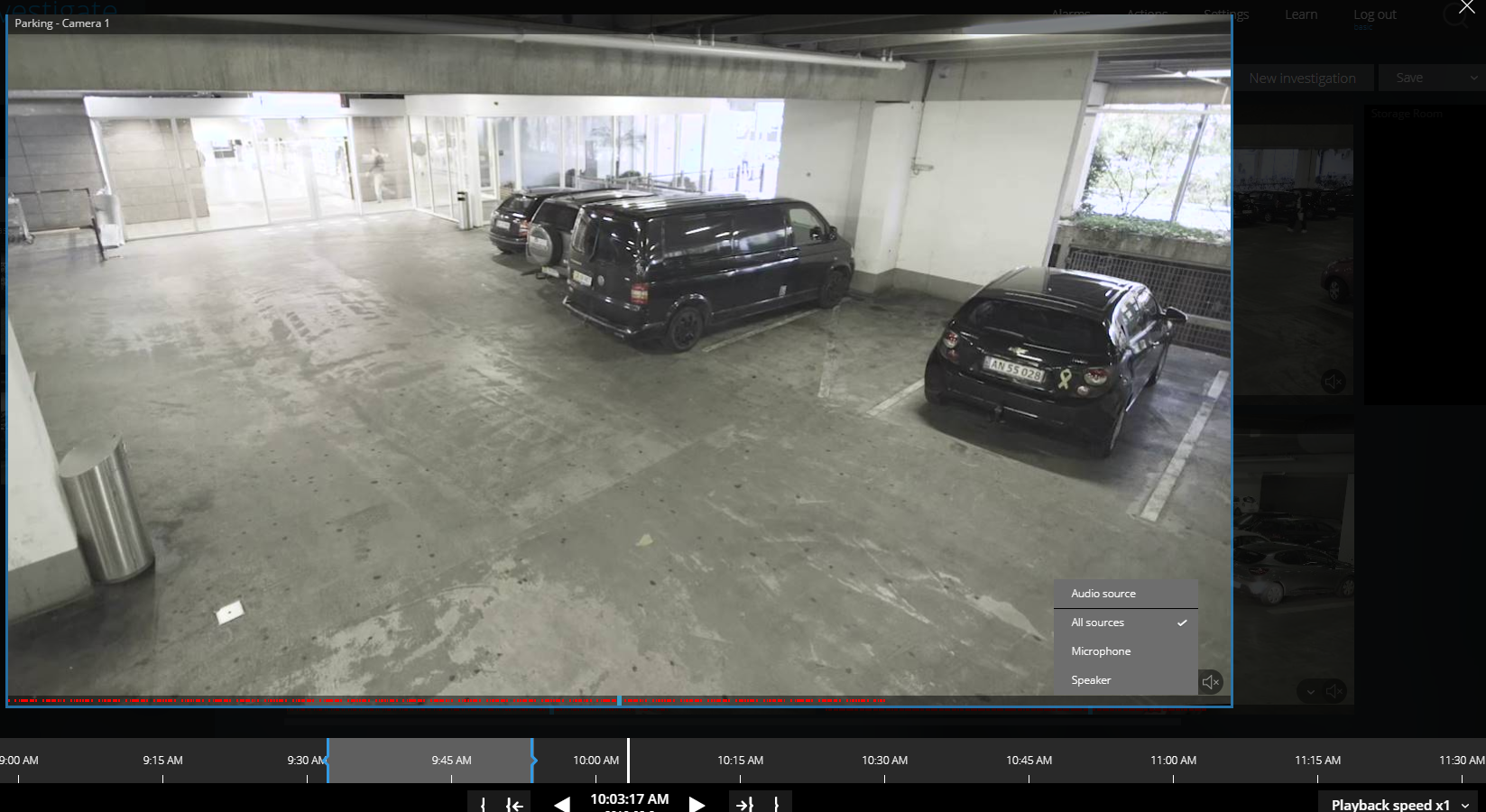

  • To listen to the recorded incoming audio, click to start playing the audio while playing back the video recording
  • To listen to the recorded incoming audio and outgoing audio, click to start playing the audio. From the Audio source list, select the audio device that you want to listen to while playing back the video recording. The options are:
    • All sources (default) - listen to both the recorded incoming and the outgoing audio
    • Microphone - listen to the incoming audio only
    • Speaker - listen to the outgoing audio only
