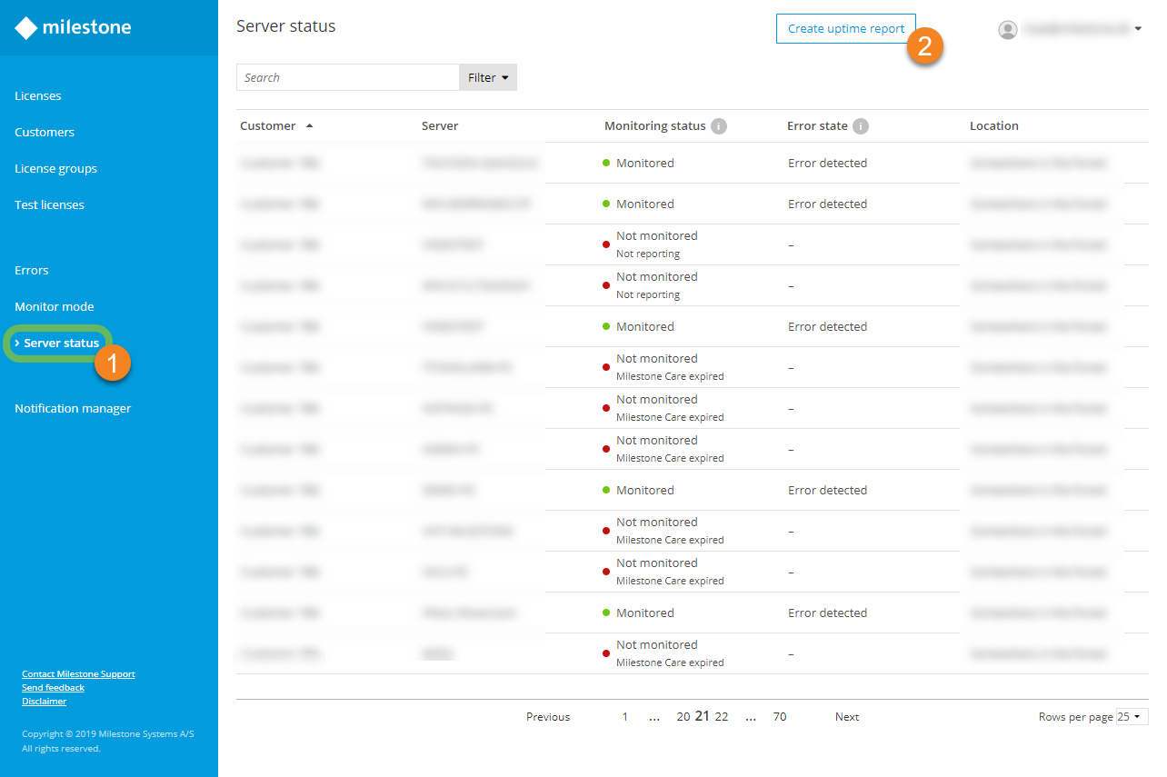

  1. In the main menu, select Server status, and then select Create uptime report .
    Create uptime report from the Server status page in Milestone Customer Dashboard.
