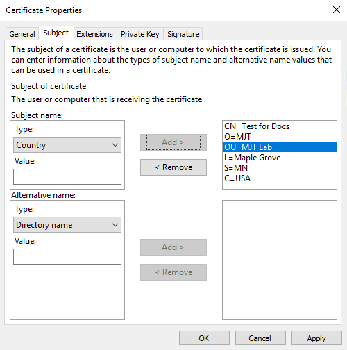

  9. On the Subject tab, enter the parameters as required by the specific CA.
    For example, the subject name Type and Value are different for each CA. One example is the following required information:
    • Common Name:
    • Organization:
    • Organizational Unit:
    • City/Locality:
    • State/Province:
    • Country/Region:

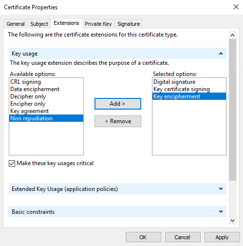

  10. Some CAs don't require extensions. However, if required, go to the Extensions tab and expand the Key usage menu. Add the required options from the list of Available options to the Selected options list.
    Key usage options in the Extension tab of the Certificate properties menu.

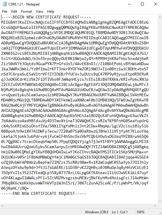

Your CA will need the contents of the .req file. You will be asked to copy the entire text of the .req file, including the begin and end lines, and paste the text into a field made available at a portal managed by the CA.
  1. Browse to the location of the .req file and open it in Notepad, and paste the text into a field made available at a portal managed by your CA.
    Copy the entire contents of the text file, including the begin and end statements.

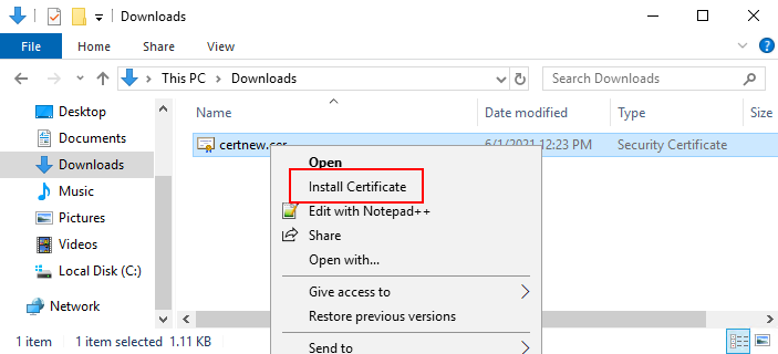

  2. When you receive the certificate from your CA, browse to the downloads folder (or wherever you choose to store the folder on the computer), right-click the certificate and select Install Certificate.
    Right click the certificate in the downloads folder and choose Install Certificate from the shortcut menu.

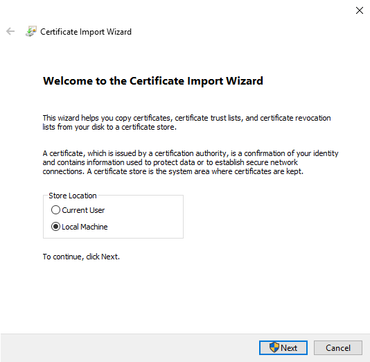

    Select to install the certificate for the local machine and click Next.
    Choose to install the certificate on the Local Machine store.
