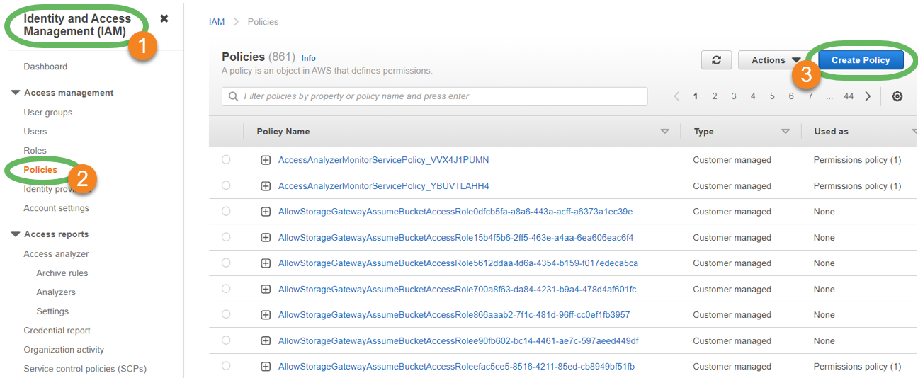

  2. The first step in creating a service role is to create a policy with the necessary permissions:
    1. In the AWS Management Console, open the Identity and Access Managemnt (IAM) page .
    2. Select the Policies node and select the Create Policy button.
    3. Create a AWS policy with the necessary permissions for XProtect.
    4. Select the JSON tab and follow this link to open a .txt file with a script that includes the necessary permissions. Copy and paste the content of the .txt file into the JSON tab. You can also copy and paste from the JSON script appendix.
      If wanted, you can download the .txt file and change the file extension to .json (XProtectCloudFormationServicePolicy.json).
    5. Select the Next: Tags button.
    6. Enter a name and a description for the policy and select the Create policy button.

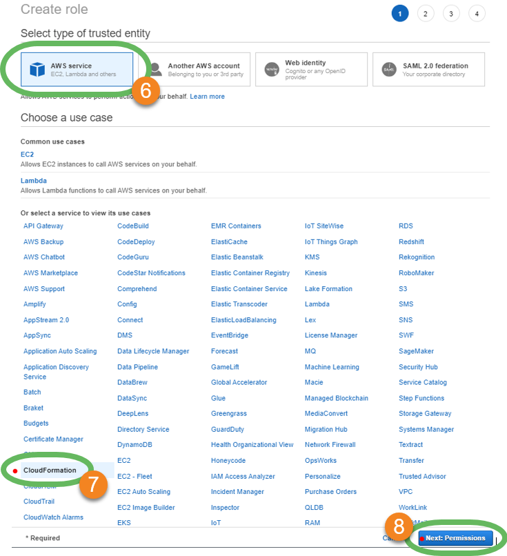

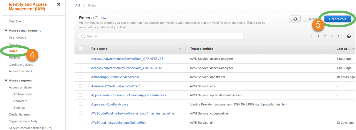

  3. The next step in creating a service role is to create a role that you combine with the policy that you just created:
    1. Return to the Identity and Access Management (IAM) page and select the Roles node and then the Create role button.
    2. Create an AWS CloudFormation service role and combine it with your new AWS policy for XProtect.
    3. Select AWS service, CloudFormation, and the Next: Permissions button .
    4. Create an AWS CloudFormation service role and combine it with your new AWS policy for XProtect.
    5. In the Filter policies field, enter the first letters of the name of the policy that you created earlier.
    6. Select the policy and select the Next: Review button.
    7. Enter a name and description for the role and select the Create role button.
