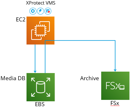

In deployments where video recordings are retained for longer than a few days, Milestone recommends using the XProtect archiving feature that moves recordings that are older than a specified threshold to a more cost-effective storage option. Archiving reduces the required size of the media database volume (disk 1) that hold your recordings, and it facilitates a cost reduction due to the reduced capacity requirement of the EBS gp2 storage.

    XProtect on AWS: Use a FSx for Windows File Server storage for archiving if the retention time is longer than 1 week.

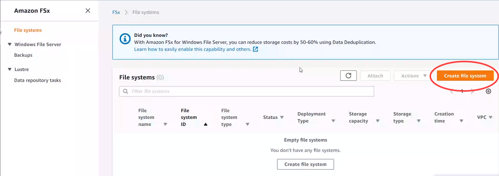

  1. Log in to the AWS Management Console and locate the Amazon FSx file system. Select Create file system.
    XProtect® on AWS: Log in to the AWS Management Console to create AWS FSx share.

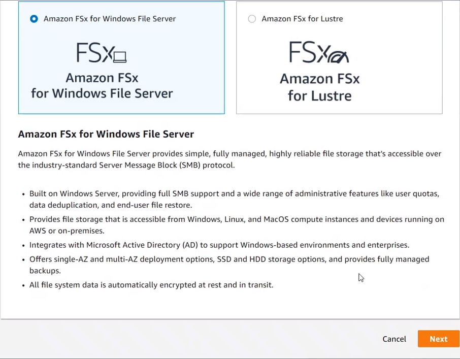

  2. Select Amazon FSx for Windows File Server and select Next.
    XProtect® on AWS: Select Amazon FSx for Windows file Server to create AWS FSx share.

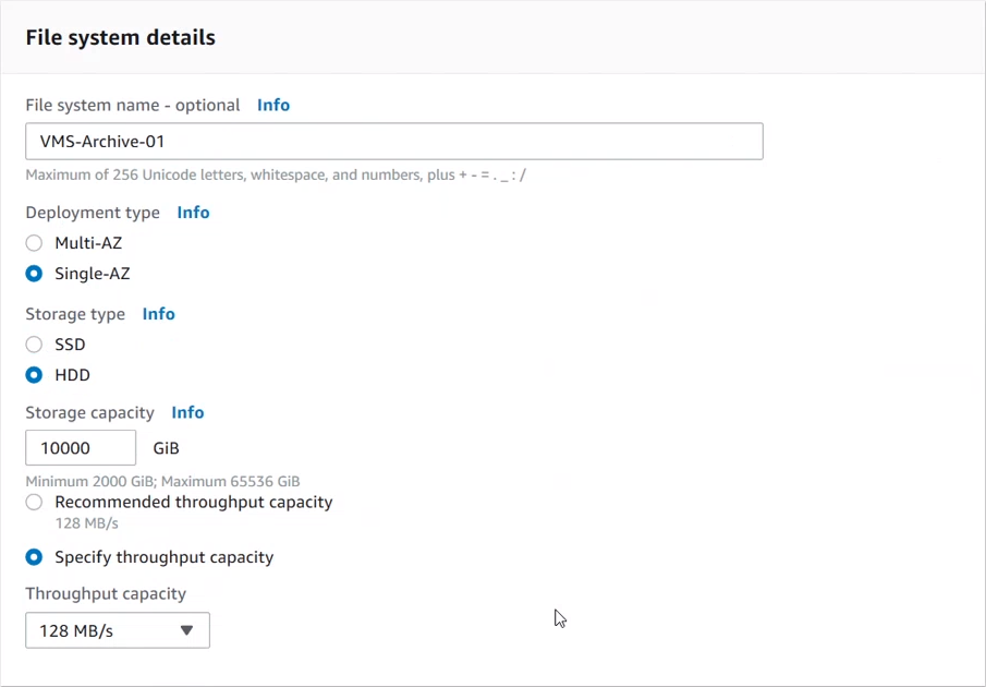

  1. File system name: Specify a name for use in the AWS Management console.
    XProtect® on AWS: Specify a file system name to create AWS FSx share.
  2. Deployment type: Select Availability Zone (AZ). Single-AZ or Multi-AZ for redundancy.
    Single-AZ has a 30-minute weekly maintenance window that you can schedule as you prefer.
  3. Storage type: Milestone recommends selecting HDD storage type for archiving.
  4. Storage capacity: Specify the size of your FSx share.
  5. Throughput capacity: Select Specify to meet your throughput requirements.
    When selecting a higher throughput capacity you increase the cost of running your FSx share.

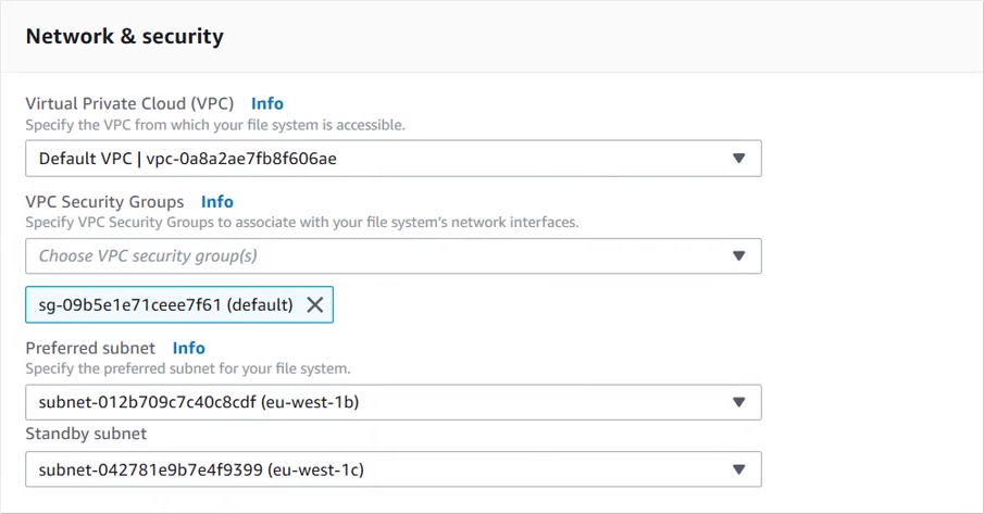

Specify Network and Security
  1. Virtual Private Cloud (VPC): Select the VPC where your EC2 instance running your XProtect system is deployed.
    XProtect® on AWS: Select the VPC for the EC2 instance running your XProtect system.
  2. VPC Security Groups: Specify VPC Security Groups to associate with your file system's network interface.
    Make sure to add the relevant ports used in AWS for SMBv3 to your VPC Security Groups.
  3. Preferred subnet: Select the same subnet as your EC2 instance running your XProtect system.
  4. Standby subnet: Select a relevant standby subnet.

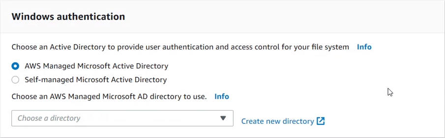

Windows authentication
Active Directory: Choose an AWS Managed or Self-managed Microsoft Active Directory to provide user authentication and access control for your file system.
  1. For an AWS Managed Microsoft AD select a directory to use.
    XProtect® on AWS: Provide user authentication and access control for your file system through AWS Managed Active Directory.

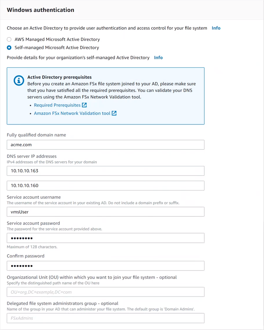

  2. For a Self-managed Microsoft AD provide the details below:
    XProtect® on AWS: Provide user authentication and access control for your file system through self-managed MS Active Directory.
    1. Fully qualified domain name.
    2. DNS server IP Addresses.
    3. Service account username and password.

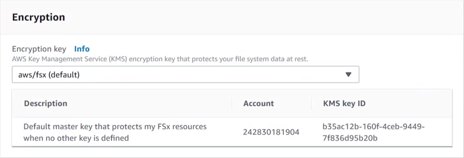

Encryption
Encryption key: Select your AWS Key Management Service (KMS) encryption key.
XProtect® on AWS: Select your AWS Key Management Service (KMS) encryption key.

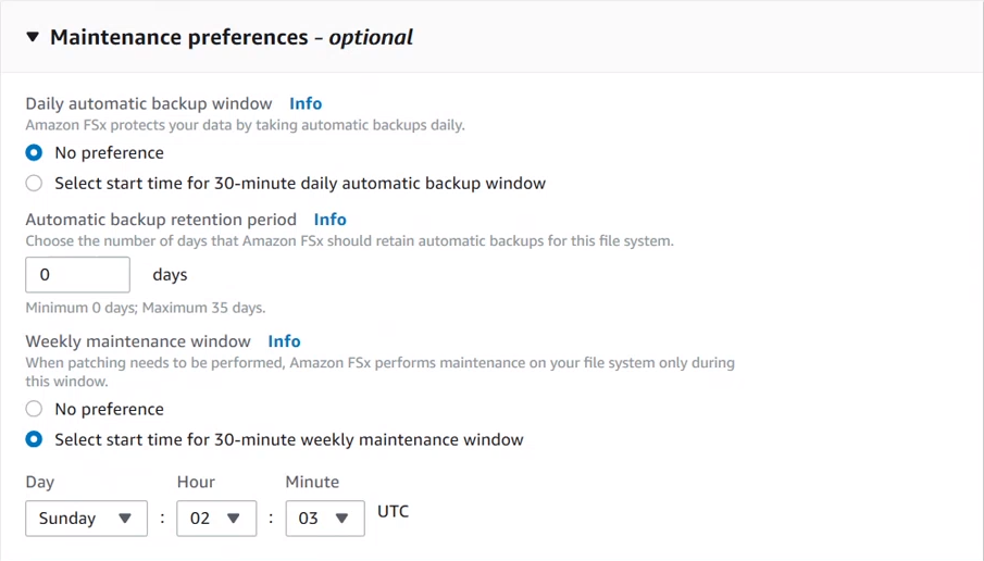

Maintenance preferences
  1. Daily automatic backup window: Select No preference.
    XProtect® on AWS: Select maintenance preference for your FSx share.
  2. Automatic backup retention period: Set it to 0 days.
  3. Single-AZ weekly maintenance window: Choose Select start time for 30-minute weekly maintenance window and specify the start time of the maintenance window.
    Specify the start time so that the maintenance window does not overlap with your XProtect system archiving schedule.

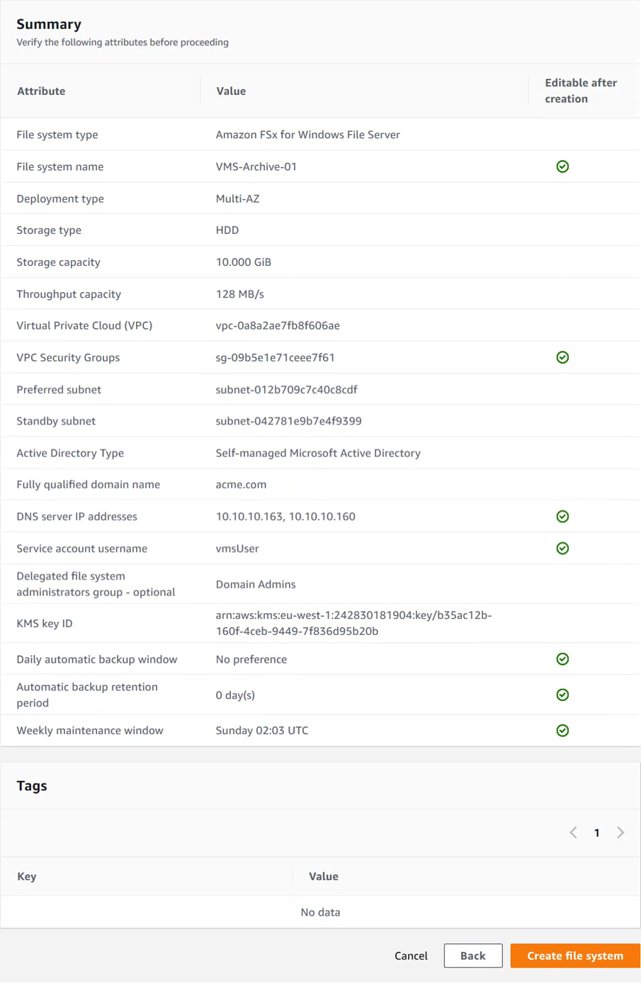

Summary
  1. Verify your settings.
    XProtect® on AWS: Verify the settings for your FSx share.
  2. Select Create file system to start the creation of your FSx share.

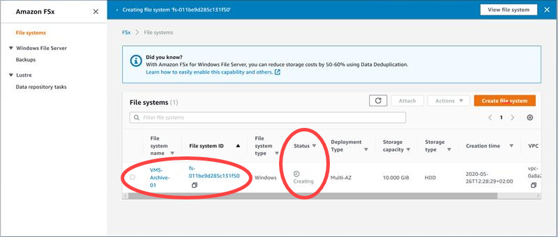

File systems

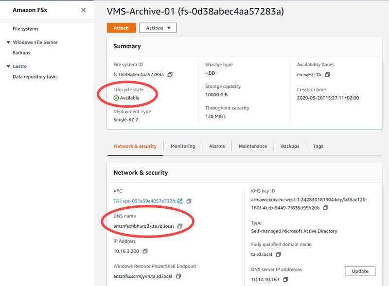

  1. Your FSx share is created and you can follow the status. The expected creation time is 20-30 minutes.
    XProtect® on AWS: Creation of your FSx share ongoing.
  2. When the status is Available, select the file system name to view the details.
  3. On the Network and Security tab locate the DNS name.
    XProtect® on AWS: Your FSx share is created and ready for use.
    You can now connect your FSx share using the DNS name and the share name as a path in the following format:
    \\amznfsx(xxxxxxxx).domain name\share
    Example: \\amznfsxscrmjyvn.acme.com\share
