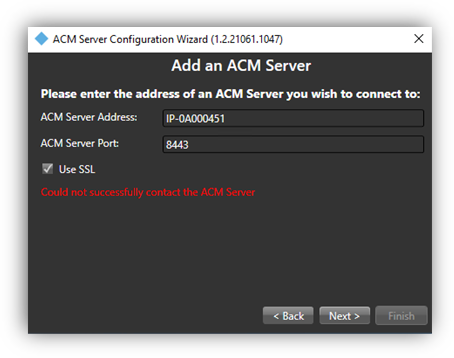

If the Milestone ACM Server Wizard fails to connect to the ACM Server on the CCure 9000 host, a red error message will appear. The wizard will not continue without a valid connection.
Reasons for failed connection |
Error message text |
Incorrect IP address or host name for the CCure 9000 host server. |
Could not successfully contact the ACM Server
ACM Server on CCure 9000 host is not running. |
ACM Server on CCure 9000 host is running with insufficient privileges. |
