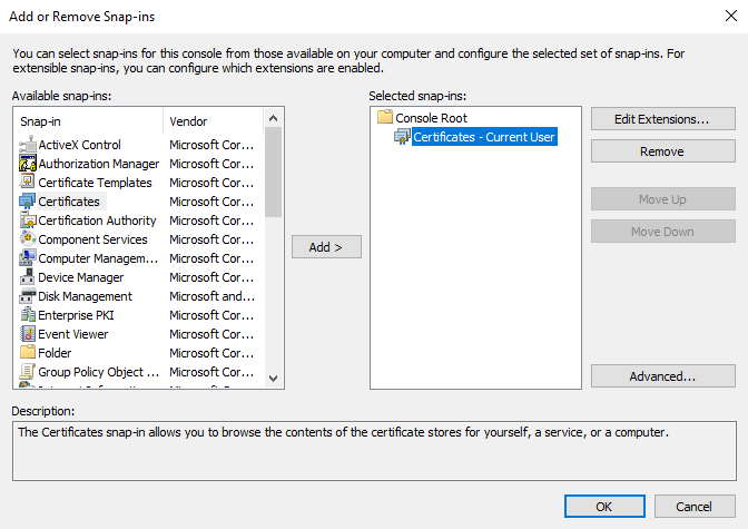

On the computer that hosts the XProtect server, open the Microsoft Management Console.
- In the Microsoft Management Console, from the File menu select Add/Remove Snap-in….
Select the Certificates snap-in and click Add.
Click OK.

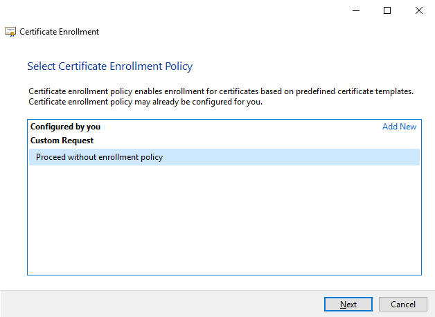

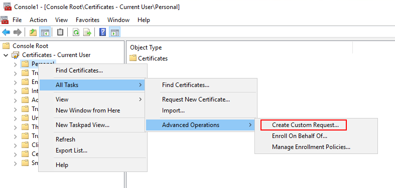

Expand the Certificates object. Right-click on the Personal folder and select All Tasks > Advanced Operations > Create Custom Request.
Click Next in the Certificate Enrollment wizard and select Proceed without enrollment policy.
If your Group Policy already contains a Certificate Enrollment Policy, you will want to confirm the rest of this process with your Domain Administration team before proceeding.
Click Next.

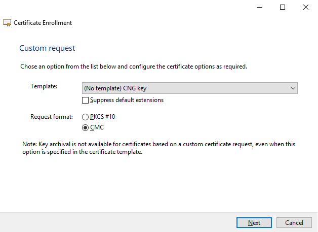

Select the (No template) CNG Key template and the CMC request format, and click Next.

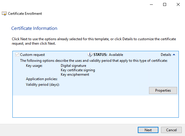

Expand to view the Details of the custom request, and click Properties.

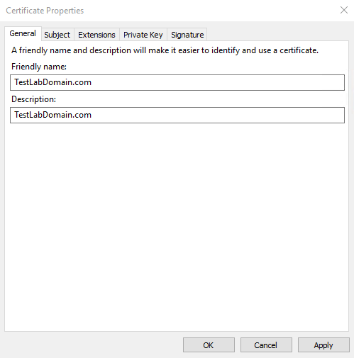

On the General tab, fill in the Friendly name and Description fields with the domain name, computer name, or organization.

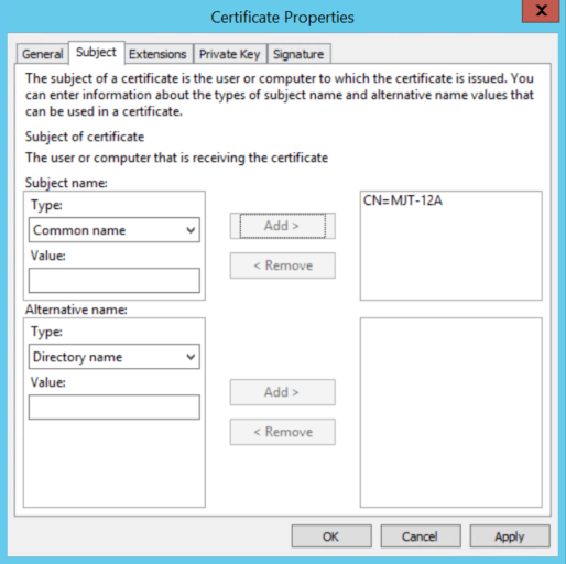

On the Subject tab, enter the required parameters for the subject name.
In the subject name Type, enter in Common Name the host name of the computer where the certificate will be installed.

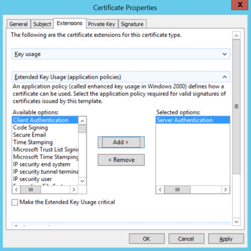

On the Extensions tab and expand the Extended Key Usage (application policies) menu. Add Server Authentication from the list of available options.

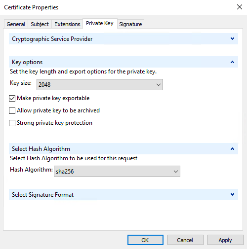

On the Private Key tab, expand the Key options menu.
Set the key size to 2048 and select the option to make the private key exportable.
Click OK.

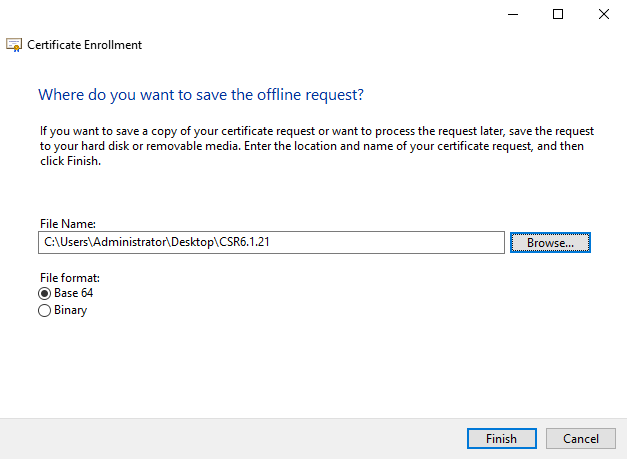

Select a location to save the certificate request and a format. Browse to that location and specify a name for the .req file. The default format is base 64.
Click Finish.
A .req file is generated, which you must use to request a signed certificate.

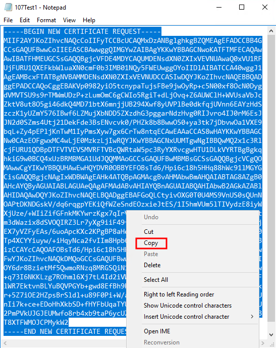

Browse to the location of the .req file and open it in Notepad.
Copy the entire contents of the file. This includes the dashed lines marking the beginning and the end of the Certificate Request.

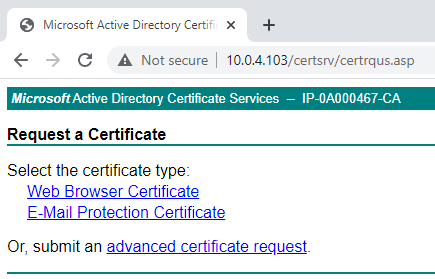

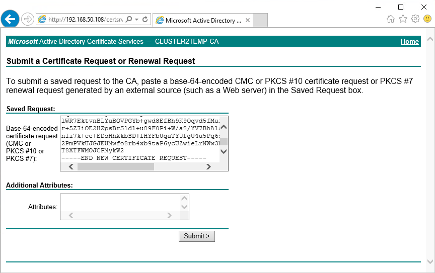

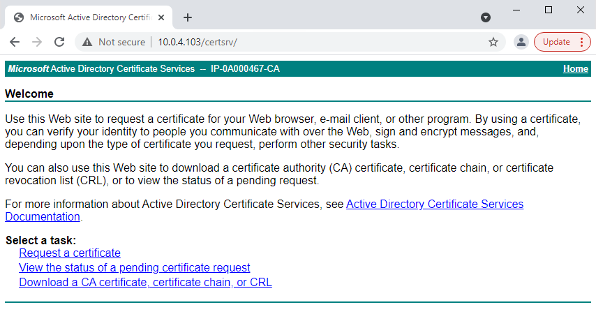

Open a web browser and enter the address of the Domain CA.
Click the Request a certificate link.
Click the advanced certificate request link.
Paste the contents of the .req file into the form. If it is required to select a Certificate Template, select Web Server from the Certificate Template list.
Click Submit.

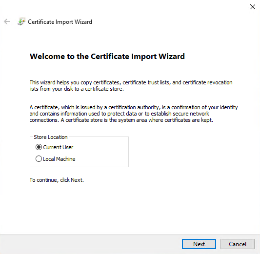

Right-click the certificate and select Install Certificate.
Accept the security warning if it appears.

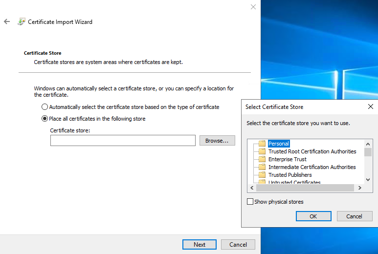

Select to install the certificate for the current user and click Next.
Choose a storage location, and browse to the Personal certificate store, and click Next.
Finish the Install Certificate wizard.

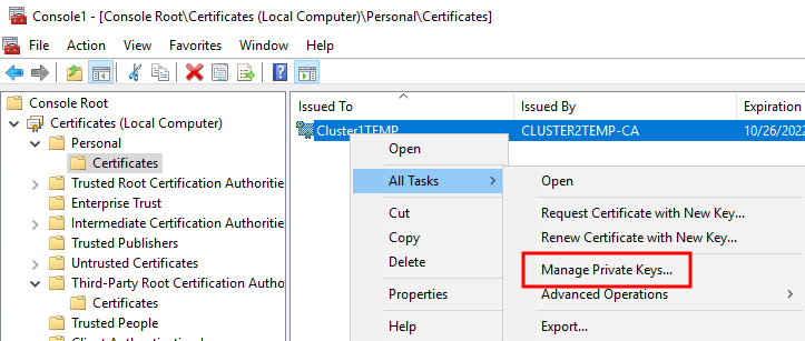

In the console, browse to the personal store where the certificate is installed. Right-click on the certificate and select All Tasks > Manage Private Keys.
