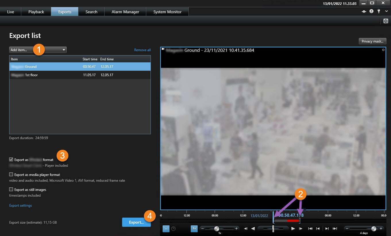

Add the video sequences that you want to export to the Exports tab > Export list.
Create the export.
Add video sequences to the Export list
You can add video sequences to the Export list on the:
Add views and cameras to the Export list.
For each view and camera on the export list, drag the square brackets to select a start and end time.
Select at least one format for the export. See Export formats.
Select Export. See Create the export.

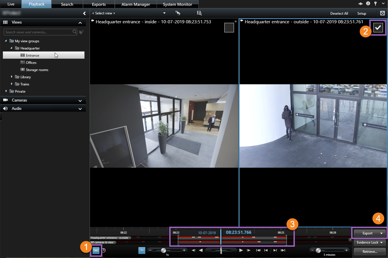

- Click to turn on time selection mode
. - Select the cameras that you want to include in the export
. - Drag the square brackets to select a start and end time for the export
Click Export > Export to add the selected video sequences to the Export list and to move to the Exports tab. On the Exports tab:
OR:
Click Export > Add to export list to add the selected video sequences to the Export list and to stay on the Playback tab. On the Exports tab:

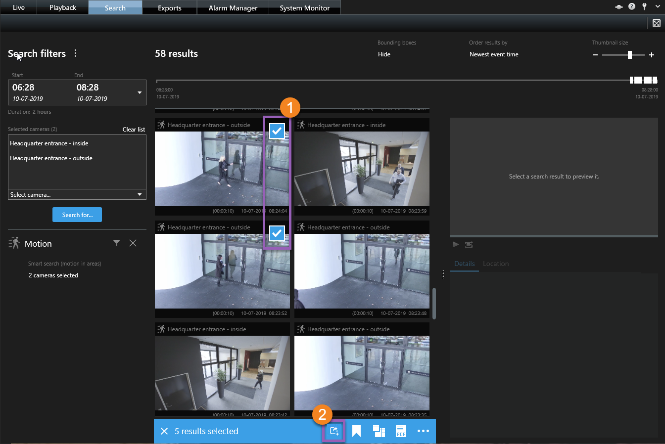

- For each search result that you want to export, hover over it and select the blue check box that appears
. - In the action bar, select the Add to export list button
to add the selected video sequences to the Export list. On the Exports tab:Select at least one format for the export. See Export formats.
Create the export
Click Export. The Create export window opens.
Enter a name for the export file.
Specify the export destination.
Click Create export.
