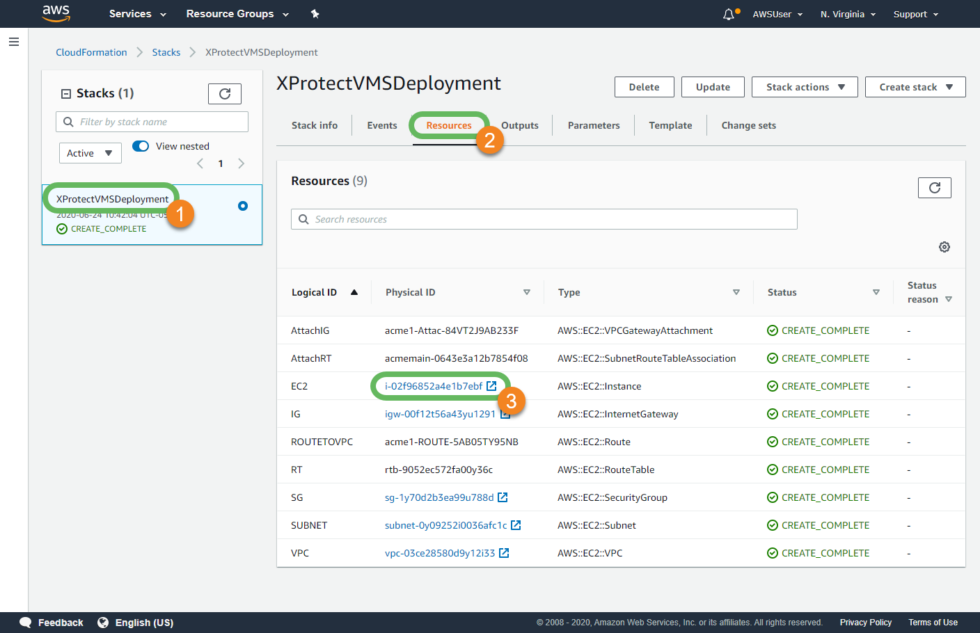

- In the AWS Management Console, open the CloudFormation page.
- Select the XProtect BYOL CloudFormation stack that you created. It is identified by the Stack name
that you specified during configuration. - In the Resources
tab, you will see all the stack elements that were created by the XProtect BYOL CloudFormation template. Select the Physical ID
link that corresponds to the EC2 instance.
