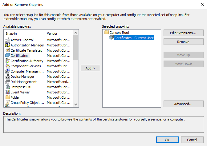

On the computer that hosts the XProtect server, open the Microsoft Management Console.
                   - In the Microsoft Management Console, from the File menu select Add/Remove Snap-in….
Select the Certificates snap-in and click Add.
Click OK.

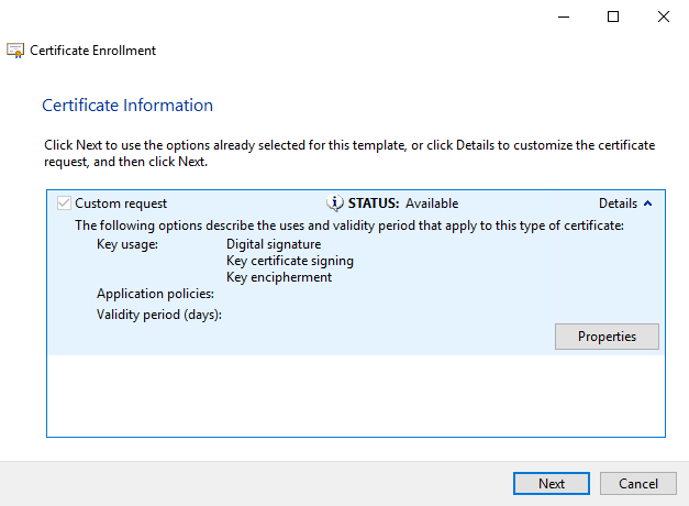

Expand the Certificates object. Right-click on the Personal folder and select All Tasks > Advanced Operations > Create Custom Request....
Click Next in the Certificate Enrollment wizard and select Proceed without enrollment policy.
If your Group Policy already contains a Certificate Enrollment Policy, you will want to confirm the rest of this process with your Domain Administration team before proceeding.
Click Next.
Select the (No template) CNG Key template and the CMC request format, and click Next.
Expand to view the Details of the custom request, and click Properties.
On the General tab, fill in the Friendly name and Description fields with the domain name, computer name, or organization.
