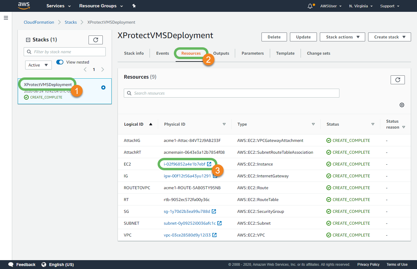

  1. In the AWS Management Console, open the CloudFormation page.
  2. Select the XProtect Essential+ CloudFormation stack that you created. It is identified by the Stack name that you specified during configuration.

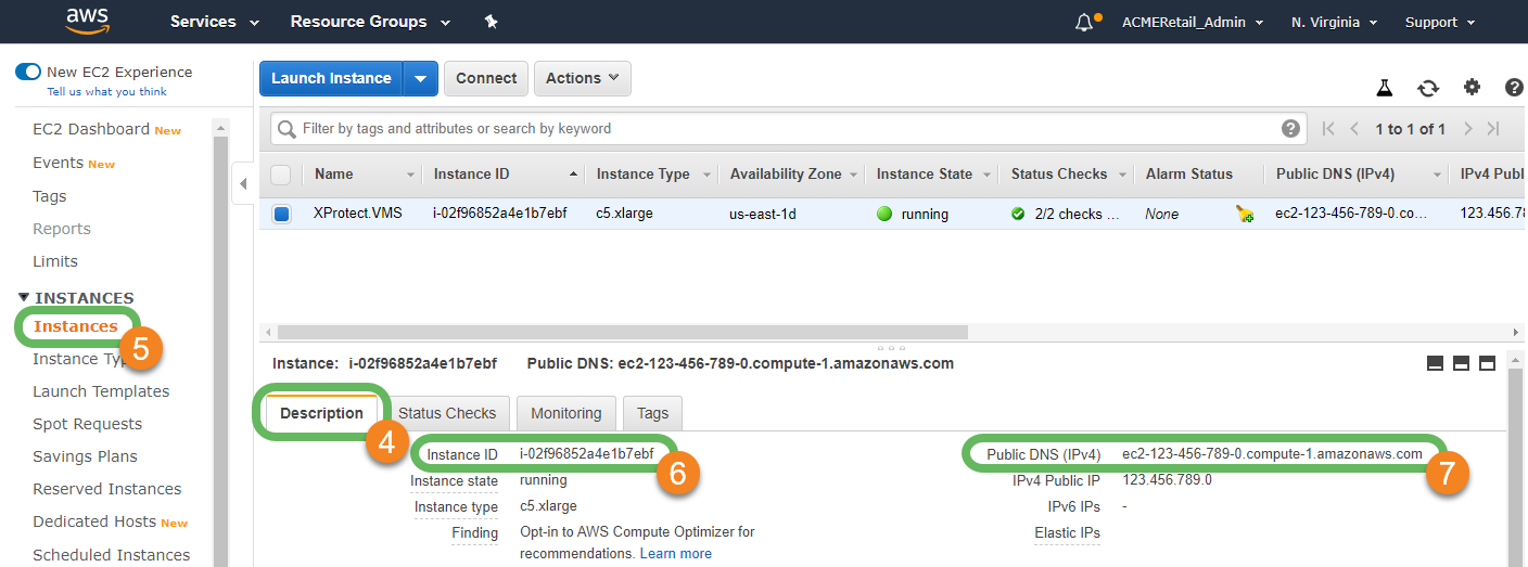

  3. In the Resources tab, you will see all the stack elements that were created by the XProtect Essential+ CloudFormation template. Select the Physical ID link that corresponds to the EC2 instance.
  4. In the Description tab of the EC2 Instances page, locate the Instance ID and Public DNS (IPv4) fields.

  1. Open a web browser and enter the Public DNS (IPv4) followed by port 8082 in the following format:
  2. https://<Public DNS of the EC2 instance>:8082
  3. On the login screen, enter the following credentials, using the Instance ID located above:
    User name: ec2-user
    Password: AWS<Instance ID of the EC2 instance>
  4. Select Login.

    Address: <Public DNS of the EC2 instance>
    User name: ec2-user

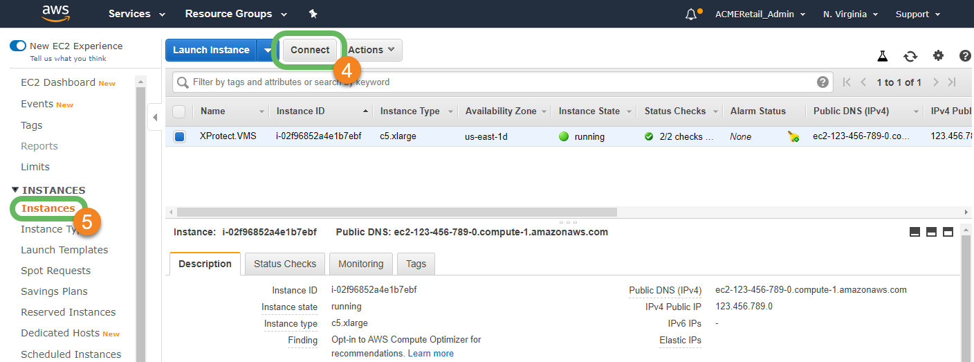

  4. At the top of the EC2 Instances page, select Connect .
  5. In the Connect to your instance window, select Get Password.
