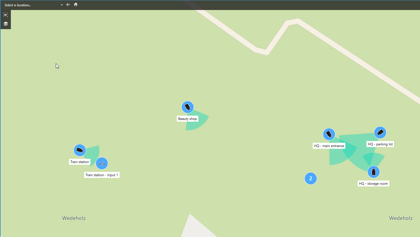

Grouping of devices (explained)
When cameras and other types of devices are placed close to each other and you zoom out, the devices are grouped and displayed visually as circular icons.
The cluster shows the number of devices inside the cluster. As you zoom in again, for example by double-clicking the cluster, it turns into devices and possibly sub-clusters.
Clusters turn blue when you select them.
If a cluster contains different types of devices, for example cameras and microphones, then the cluster only shows the number of devices. However, if a cluster contains only one type of device, then the cluster shows both the type of device and the number of devices. This scenario is illustrated in the following image:
