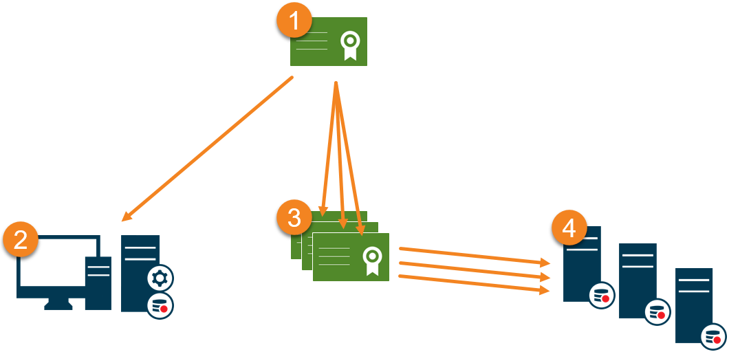

  • Certificate distribution
    The graphic illustrates the basic concept of how certificates are signed, trusted, and distributed in XProtect VMS.
    A CA certificate acts as a trusted third-party, trusted by both the Subject/owner (server) and by the party that verifies the certificate (clients) ( see Create CA certificate).
    The public CA certificate must be trusted on all client computers. In this way the clients can verify the validity of the certificates issued by the CA (see Install certificates on the clients).
    The CA certificate is used to issue private server authentication certificates to the servers (see Create SSL certificate).
    The created private SSL certificates must be imported to the Windows Certificate Store on all servers (see Import SSL certificate).
