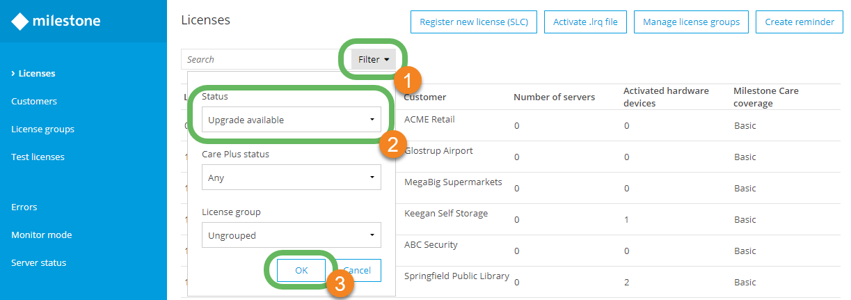

  1. Log in to Milestone Customer Dashboard (https://online.milestonesys.com/).
  2. Select Licenses in the main menu.
  3. Select Filter, then in the Status dropdown list, select Upgrade available , then select OK.
All the licenses that are eligible for upgrade appear.

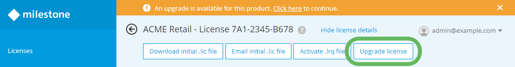

  4. If an upgrade is available for the license, an orange bar appears at the top of the page. To start the upgrade process, select Upgrade license or the Click here link in the orange bar.

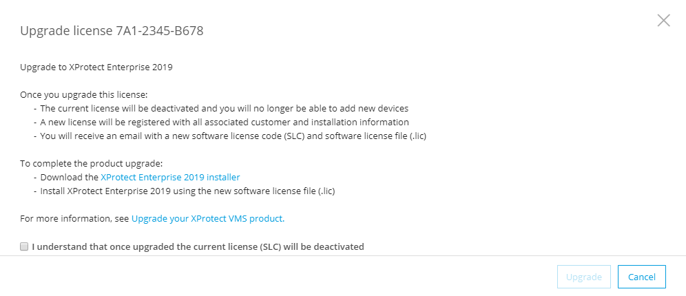

  5. The Upgrade license dialog box appears, detailing the license upgrade process. After a license is upgraded, a new software license code (SLC) will be registered with all associated installation and customer information.
    After you upgrade the software license, you can no longer use the previous license in your XProtect VMS installations.
    Select the I understand that once upgraded the current license (SLC) will be deactivated check box, then select Upgrade.

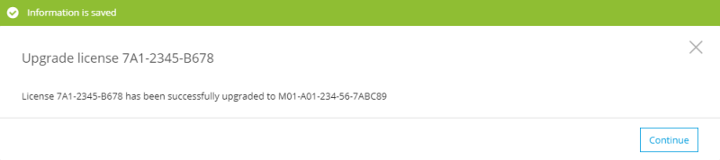

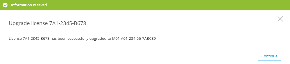

  6. After the upgrade process finishes, a confirmation window shows the previous SLC for the license that you upgraded, and the new SLC for the upgraded license. You also receive an email with the new SLC and software license (.lic) file.
  7. Select Continue.
