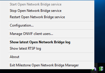

  4. On the Milestone Open Network Bridge Manager tray icon, select Manage ONVIF client users.
  5. Enter the domain\user name and password for each user who has ONVIF client rights and click Add user.
